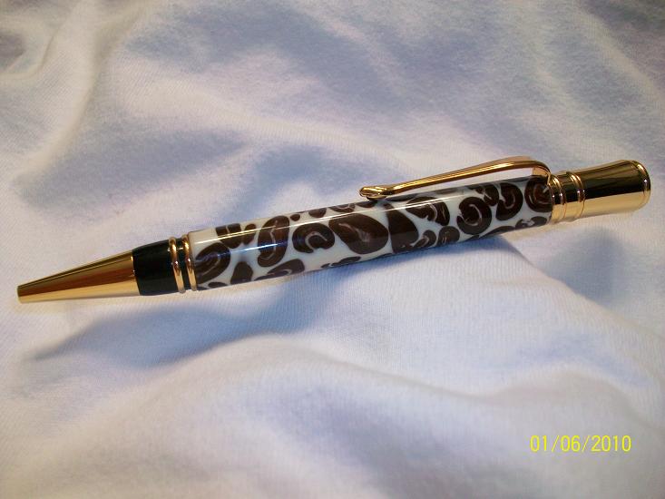

Hi Steve, you can use whatever chisel you like to turn these as long as it is a very sharp tool, my one was turned using a 1/4" gouge, the question you asked about should I seal it, my suggestion is because it's for your wife and she loves her coffee then don't seal it, if you seal it you are going to lose some of that fragrance and it would make it more durable.
Going back to the turning, turn these blanks and drill with a little more time and care, the bean is soft and the resin is hard and it's easy to lose the center of the bean, now if this happens and no doubt it will try to collect some of the shavings that come from the turning, but better still buy a packet of ground percolated coffee mix up a little paste with thick CA and just fill the center of the bean or even if you lose a bean on the end of the blank you can still fill and repair the blank,
build up the hole and wait for the CA to set and return or sand it, I wouldn't go too mad with the Micro Mesh maybe stop on 1500 grit or a little higher, and then just leave it natural.
So when you're out hard at work Steve your wife will have the ladies round for a coffee morning she will be wanting to show her pen to the ladies and they will be wanting to smell the pen once she tells them it's made from coffee beans, why I don't know I think it's a women thing to smell things before they comment, LOL.
This is my one I turned using the tips I have given you Steve some other penturners will have other good ideas and tips on to turn the coffee bean blank.
Good luck Steve
Let us know how you get on.

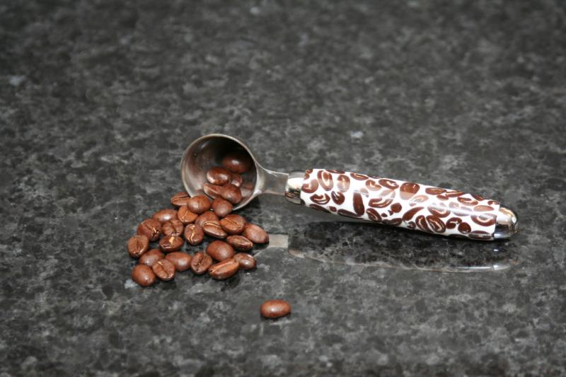

I made a coffee scoop with one of these (it was the 3rd thing I turned... :eek:) and I purposefully went slow and took like cuts. Be careful of tearing out beans, I only managed to do it to one...
One way to fix it (if you happen to buy beans rather than grinds) is to thick CA in a bean of relatively the same size, then take SUPER light cuts to get back down to round on the bean before continuing. I managed to fix one tear out like that...
CA over the top then polish and it will look great.

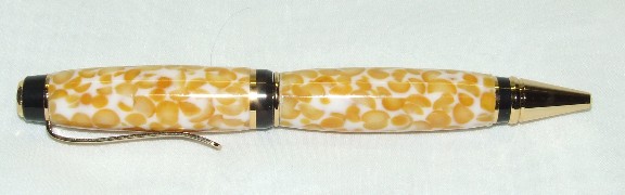

I've never made a coffee bean pen, did do one from yellow split peas once... it turned out fine... I always use a really sharp skew to turn my plastics... after I saw ED do a demo on plastics a few years back.... anything else I use tends to make the blank chip. A sharp skew and light cuts will make cool ribbons that you have to wire brush away.

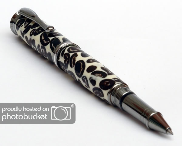

All great comments, I would say the same! Most importantly, take your time, and definitely stabilize with thin ca.
