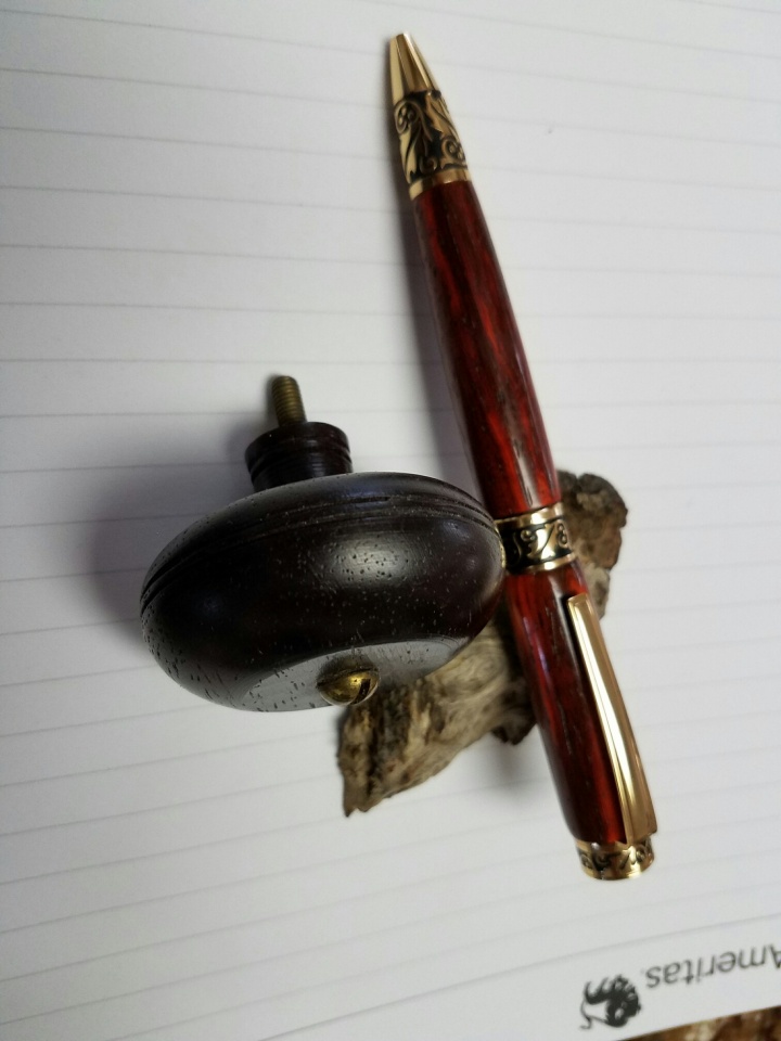

This photo is what UV and time can do. The knob was turned 30 years ago.
The pen is two days old. This is the same wood
I have 50 year old cocobolo collectors cue with a satin finish and it hasn't turned black ..
IMO
The dirty oil from peoples hands turned the door knob black......
