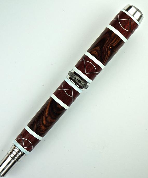

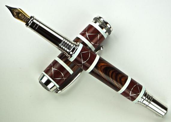

I was over at Alton GreenMtGuy's house last week to cut up some wood. He was cutting up some Cocobolo and I just had to have some so he relented and sold me a few precious pieces. This stuff is very tight grained and just beautifully figured. Ok so here is a list of parts.
Main Wood: Cocobolo ala Alton
Scallops: Blood Wood
Segments: Aluminum and Pick Guard
Main Glue for Segments: UFO Thick by Hot Stuff (no breaks at all)
Tube Glue: epoxy
I hope you like it.

Mike - I guess this could be a PM but, are you using different thicknesses of the pick guard or doubling up in some spots? The top of the cap looks thin comparatively. I like both of the thicknesses - just wondering.
Also, does the pick guard at the end of the blanks add strength against blowouts when drilling and turning?
Thanks for inspiring!
Feb 24, 2012
4,368
Claremont NH
I am not using different thicknesses. It is not easy to get an exact glue up and sometimes you have to sand away more than you would like to. So in order to get away with it you need to choose wisely. If I have a thin spot in a cap it always goes near the clip. This way it is at least somewhat hidden and not right in the middle of the pen when it has the cap on. If it is on the main barrel I would put it on the end of the finial because again I don't want it to be in the middle of the pen when the cap is on. Most people present their pens with the cap on so if common sense prevails you will protect that configuration at all costs.
Yes the pick guard is on the ends to protect against blowouts if I didn't use pick guard I would find something else. You really can get away without it but you really have to be careful those pieces of scallop are very small maybe leave a bit of extra at each end.. I am trimming these segments very close to the limits.
You are really getting all of my secrets here I hope you are happy.:biggrin:

I would like to hear more about, "Main Glue for Segments: UFO Thick by Hot Stuff (no breaks at all)"?
-Where did you get it?
-Are you only using it for segmenting pieces?
-What's the set-up time like?
-Are there any of those terrible fumes(like with CA)?
Scott (keep 'um comin'!!!) B
Feb 24, 2012
4,368
Claremont NH
Please see below for my answers to your questions.
Great looking pen! The segmenting is off the chart great!
"I have been getting it at HobbyLinc but they are so slow to ship it isn't funny I have been going back and forth with Glenn the owner who is a member here and I think he would like to come up with something to help us all. Stay tuned...."
"I only use it for segmenting"
"The setup time is pretty much like regular CA"
"Odorless so no fumes."

Mike, your segmenting is stellar. I'm always excited when you post new pens.
All of my segmenting attempts have met their end in the drilling stage. But as frustrating as that gets, when I see something like this, it makes me want to dust myself off and give it another whirl.
Feb 24, 2012
4,368
Claremont NH
Don't give up. How are you drilling? I drill on the lathe! Are you using sharp drills? Are you drilling a pilot hole? I drill my 12.5 caps in three steps. I drill my 10.5 in two steps. You really need to have all of these drills very sharp. You need to drill in a bit and back out and wait. I have a dust collector going right behind my drill and let the air from that go over the drill to help with cooling. I will try to do a video about drilling these blanks to help but I only have limited time to work on these things I still need to crank out some pens myself.
