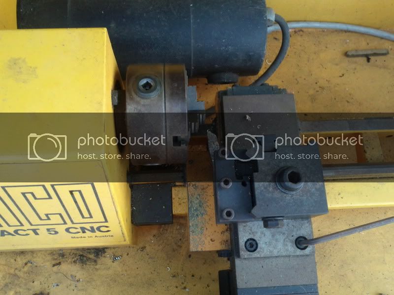

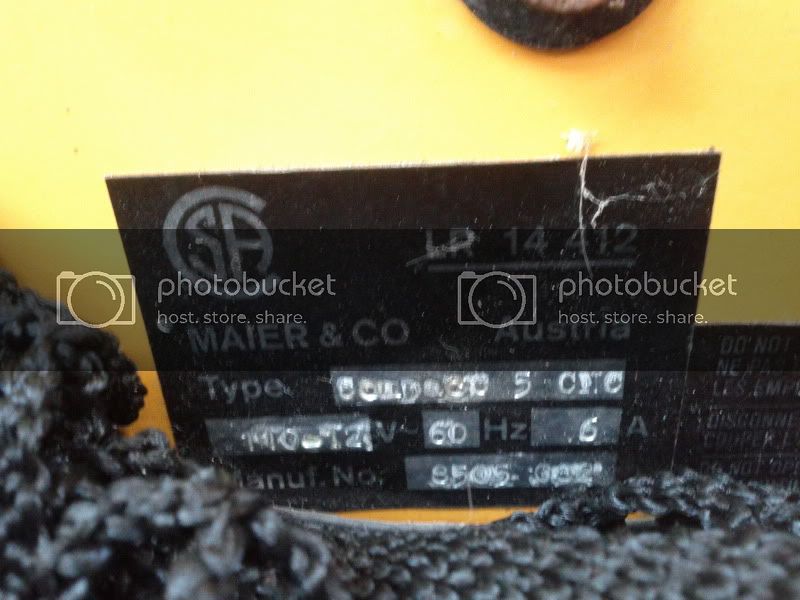

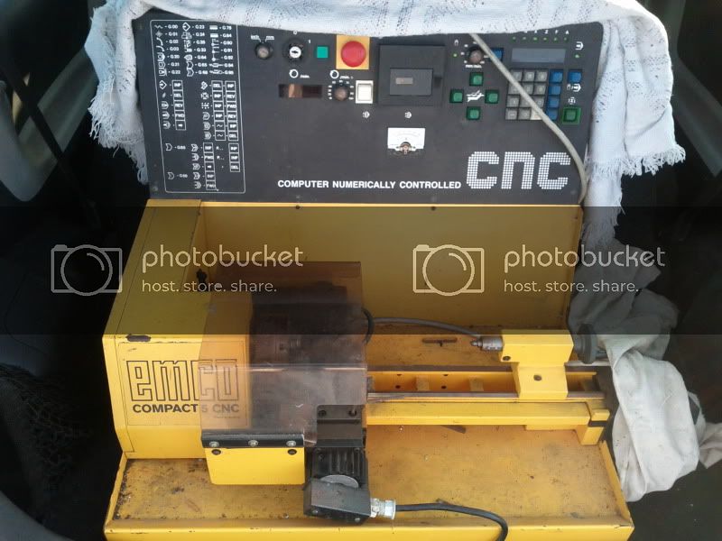

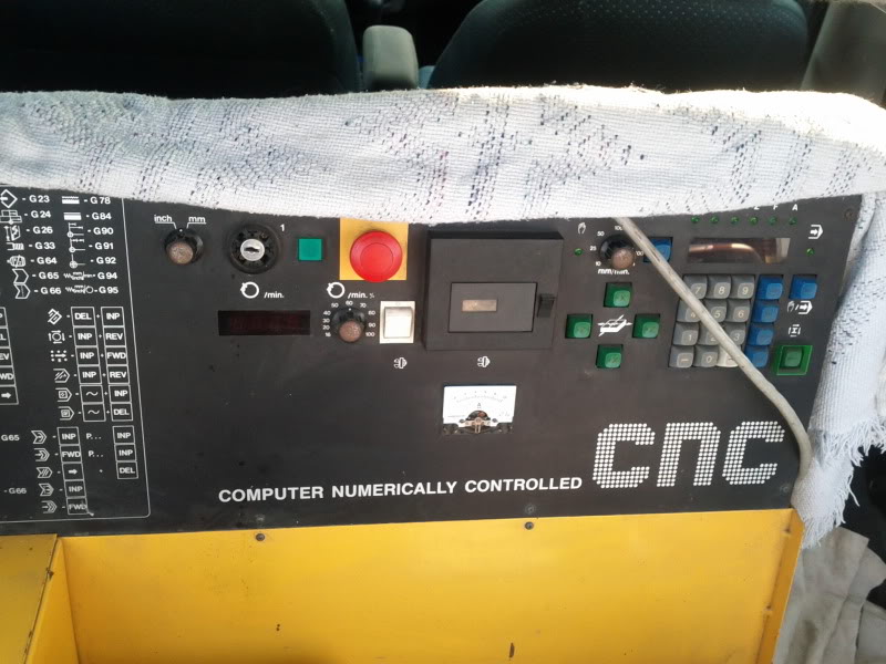

I have no clue. It's an Emco Compact 5 CNC.
It has the big panel on the back of it.
Here's what I have.....
