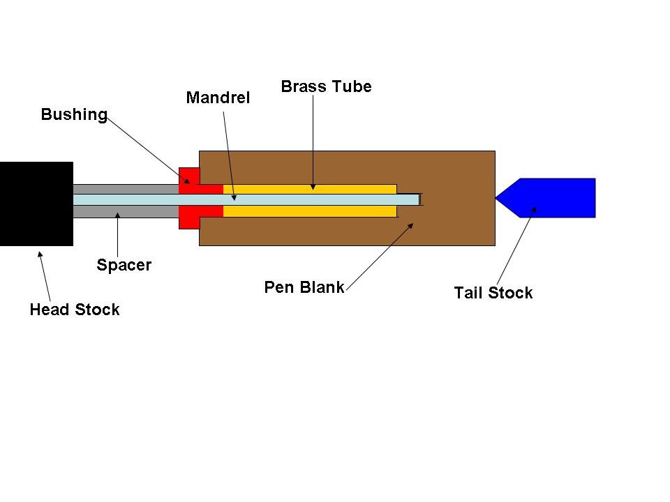

Don Ward provided some instructions and a simple diagram on how to do this. I had already bought the AS mandrels but tried his method and it worked just fine.
It should be in the tutorials but I can't find it, if interested try dropping him (it's virgil) a note.

its_virgil
Jan 1, 2004
8,127
Wichita Falls, TX, USA.
I've made a better diagram. See if this one is better.

Don's diagram above says it all.. Beleive Russ Fairfield has a video describing this process. http://www.woodturnerruss.com/Video.html it's about mid way down the page Pen-2 "Advanced Pencrafting"
