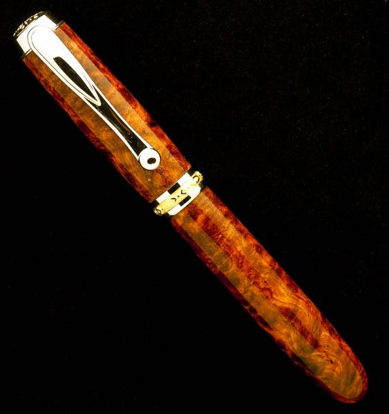

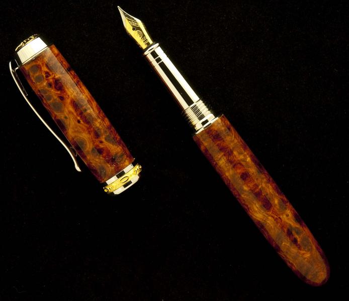

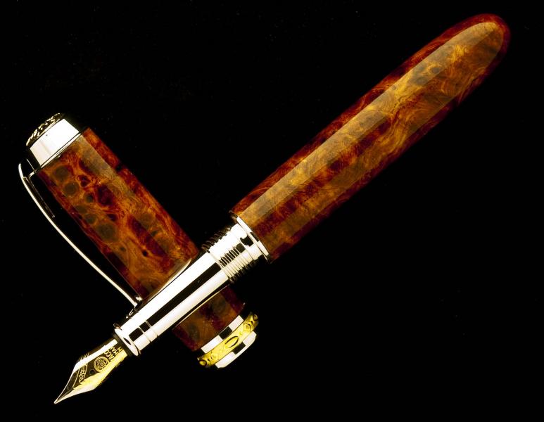

Made it early this morning. Had fun... Comments welcome but most of all thank you for looking!! Have a great Sunday. Doc:)

Dang, Doc, I think you hit a new high water mark with the finish on that one. Great pics too. Which closed end method did you use?
wizard
Aug 27, 2009
3,569
Houston, Texas
James,
I used an Arizona Silhouette Jr. Gentleman Mandrel in a PSI Collet Chuck.
Regards, Doc

Great looking pen as always. As others have mentioned nice finish. Did you enhance the grain by using blo before CA???? What did you do different with this pen for finish that you have not done in the past being you said you went overboard on the finish??? Thanks for showing.
wizard
Aug 27, 2009
3,569
Houston, Texas
John,
Yep, I did enhance the grain using one swipe with BLO after sanding to 600 grit and getting the wood clean from dust with an alcohol pad. After my usual 6 coats of medium CA and MM (wet) from 1200 to 12000, the pen had some fine but noticeable ripples in the CA finish. So I lightly sanded it back from 150 to 600 grit and cleaned it with an alcohol pad again. I then applied 6 more coats of medium CA and then again MM'd (wet) from 1200 to 12000 and HUT Plastic Polish. By the time it was over, the pen looked like it was under a layer of glass. I've never really done that before and it was definitely not intentional. Regards, Doc
