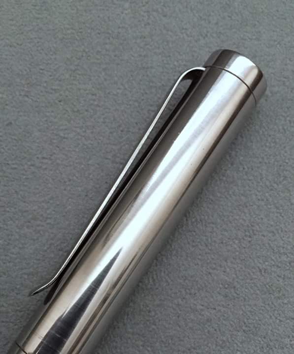

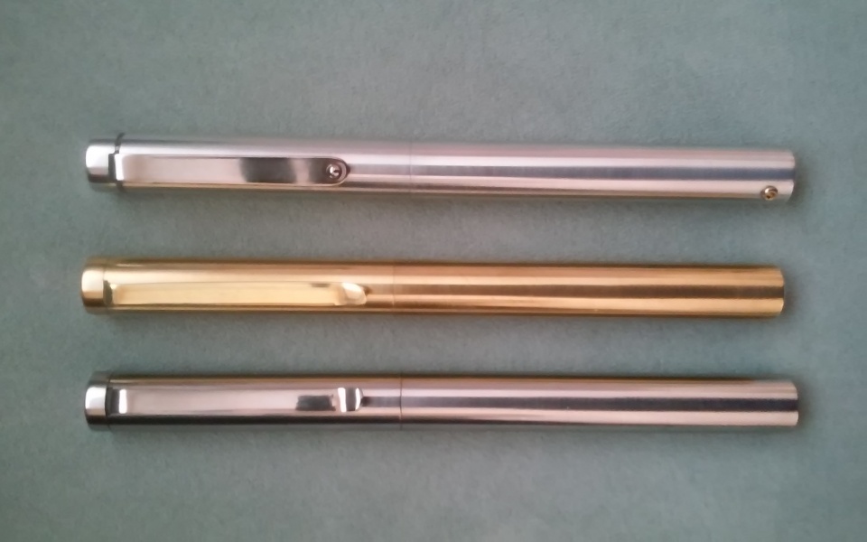

More4dan
Mar 17, 2016
2,102
Katy, TX
I've used 0.030" brass and titanium for clips. The brass could be stiffer 0.40 would be better. Just right for grade 5 titanium. I used a metal bandsaw to cut to rough shape and a sander and file to final shape. Check ebay for sheet goods. Also knife maker supply companies carry similar thicknesses in many materials. Its used for pocket knife liners.
More4dan - any issues with cutting the titanium? I'd considered the knife makers as a lot of them make clips for their knives as well.
~m
I use titanium sheet for making pocket knives. It cuts easily with a metal band saw and I shape with a sander. I don't seen a big difference working it verses 316 SS. Drilling requires sharp bits for both and working through several diameters to the final size. To bend i heat with a torch first. Titanium can also be colored anodized with heat or electricity in colors from gold through blues purple reds or greens. Its high yield strength makes it a good springy material without having to work harden like brass or 300 series SS or heat treat.
