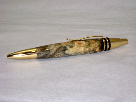

Grizz
Banned
Oct 26, 2007
917
Not sure what the problem might be? Every click I've tried as worked great.
