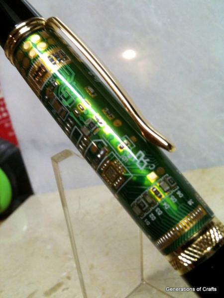

Here is one I just finished (from woodcraft)...Tried to get a close up of the components. During their sale, I got it for $15 and this is WITH the pen kit. Not to bad of a deal.
