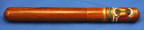

A friend wanted a pen shaped like his uncle's favorite cigar. He brought over some cigar bands and here is what I made for him. Not sure about the wood. If anyone recoginzes it let me know. I think maybe some type of walnut. It was in my "don't know" drawer but he thought it looked close to the cigar leaf color. The kit is the penache. Just saw the smudge of something on the band and the dust on the nib. sorry about that. Also, not sure if the band placement is correct...I don't smoke but I should have researched that. Next time. Comments welcome good, bad, or indifferent.

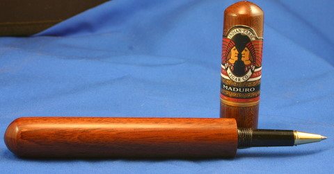

Thanks for all of the comments. I meant to add mahagony to the wood that I thought it might be. The pen is .744 inches in diameter. 7.25" in length and the panache CB/coupler parts are recessed. It was tricky matching the diameters at the junction of the two pieces. Two blanks were used ane were turned separately. Getting the CA finish over and around the cigar band was a challenge. I overlapped the band in the wrong direction and the edge kept hanging during the finishing process. It is rather large holding in in my hand and not that comfortable when writing with it, but I don't really think this pen will see much writing. I just hope the customer likes it. I'll deliver it tomorrow afternoon.

Thanks Ken. I think I should have had the cigar band put on by you instead of trying to glue it on. The more I look at it the more I think it is mahagony also.

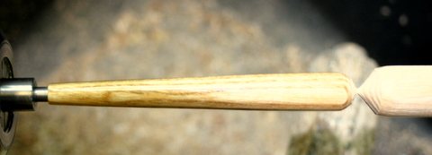

How difficult was it in getting the ends to have the correct shape?
I really like how it turned out. What size are the Panache tubes? How does using that particular kit compare to using a Baron for example?
I'm looking at figuring out (along with the AS DVD [:D] ) how to turn to turn closed end pens. My Granddad's bday is next fall, and I hope to have mastered the skill enough to turn out something very similiar to what you've done.

Using the setup in the sketch I posted works pretty well. After turning the blank to the desired length,I round over at the appointed spot for the end. I then sand and finish all but the end. I'm not using the entire length of the blank and after parting off I tape the blank, using masking tape, to the mandrel and finish shaping, sanding, and finishing the end.
The panache uses 31/64 and 12.5 mm drill bits. I did not have a pin chuck for these tubes so I used this alternative method which I use quite often. A pin chuck would be a little easier. Maybe the tubes are the same size as one of the kits for whick Arizona Silhouette sells the closed end mandrels. I do use this method often.
I've not used a baron but I suppose it could be done. I purchased 6 panache kits and honestly, I don't like the pen so I've been using them for customized closed end pens. I didn't want to invest in a pin chuck for just 6 pens and did not investigate other kits using the same size tubes.
