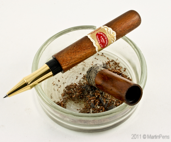

Working to improve the look of the ash and the diameter of the piece.
Also someone mentioned that I should try putting the ash part in the cap. It took me a while to get my brain flipped around, but it makes more sense to do it this way.
The wood is Koa and the ash is Grey Buckeye. The pen uses parts from the Churchill kit and the Gentleman's kit.
Thanks to Lee (leestoresund) for the cigar label!
There are things I like about it and things I don't like about it.
The finish is a little tung oil and later a couple coats of thin CA buffed with 0000steal wool. (I don't like glossy cigars)
Enjoy. Comments always welcome.
Martin

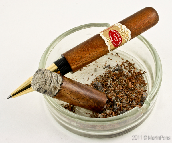

they amaze me every time I see one you do Martin. I do like it better with the ash on the end of the pen not the cap. It makes more sense to me that way, as the pen is what you right with not the cap.

Great looking pen Martin. I was hoping to try putting the ash on the cap end before you got to it! The other comment I made, which IMO, would make this pen look that much nicer, would be to add a lower label so one edge is at the seam, so it hides it.
I hope to try a few of these when my labels get here (thanks to you!!) :biggrin:

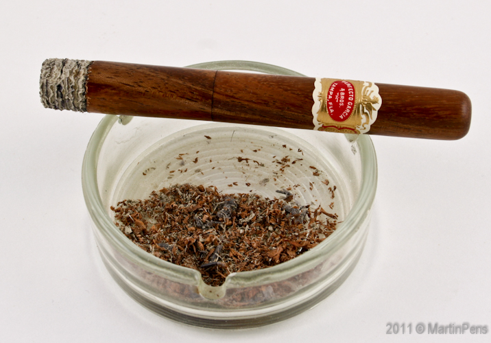

I'm trying to track down where I got the nice grey buckeye from. It's so perfect for ash. And would also like to thank whoever suggested switching the ash to the other end. Makes sense now! Duh! These do take a little longer than 20 min to make. ; )

Go for it! I look forward to seeing what you come up with. These are fun to make, but I don't find them very stylistically enjoyable to write with. I'm working on an idea to maintain the illusion and yet have a stylistically pleasing pen. Haven't been able to get it to come out yet, but it's the challenge that I'm enjoying.
I need to make one for the guy at the cigar shop. He doesn't seem to care much about the style, he just likes that it looks like a cigar AND it's a functional pen.

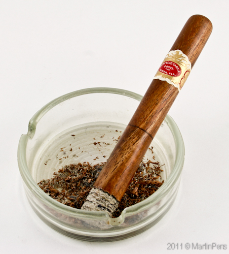

The ash is not horribly difficult. Just get a nice gray piece of buckeye - take a Dremmel to it and add some black here and there. There are still a few ways to make it look more like ash, but it's a work in progress. Getting rid of that middle line is the next challenge.
