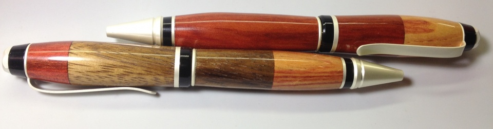

@ Everybody- Well, I knew the box of blank cutoffs I've been saving would come in handy. Grabbed some Tulipwood drops, reamed them out with a slightly larger bit, and CA glued them to the exposed tube ends. Turns out, they made some very interesting pens. One is a Tulipwood/Rosewood/Paduak "segmented" pen, and the other is Tulipwood/paduak. I was able to sand the edges square enough, and the already glued blanks, I turned with the cutoff tool to square them up. The CA line between woods is dark and thin, but distinct. Even if it does discolor, it will still look clean.
So my error turned into a good opportunity to experiment.
Cheers for the suggestions though, all good things to keep in mind.

Photos:
