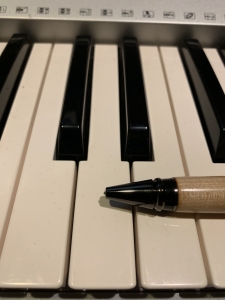

Somehow, I made a mistake in a PSI Cigar, and the cartridge doesn't retract all the way. I must have cut the tube a little short, around 1/32nd of an inch. Just enough that it will still write. I imagine I was too aggressive squaring the blank. (I've made about ten of these kits, and this is the first time I've had this issue. The longer barrel is on the bottom.)

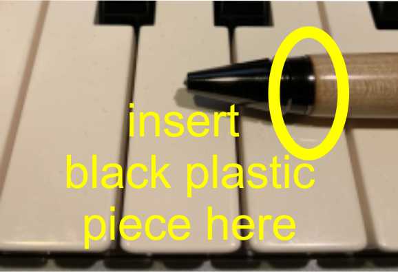

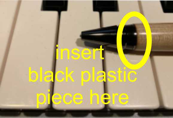

You can drill a thin black piece of acrylic, turn it to match outside diameter and insert it at the end of the pen, above the nib.
