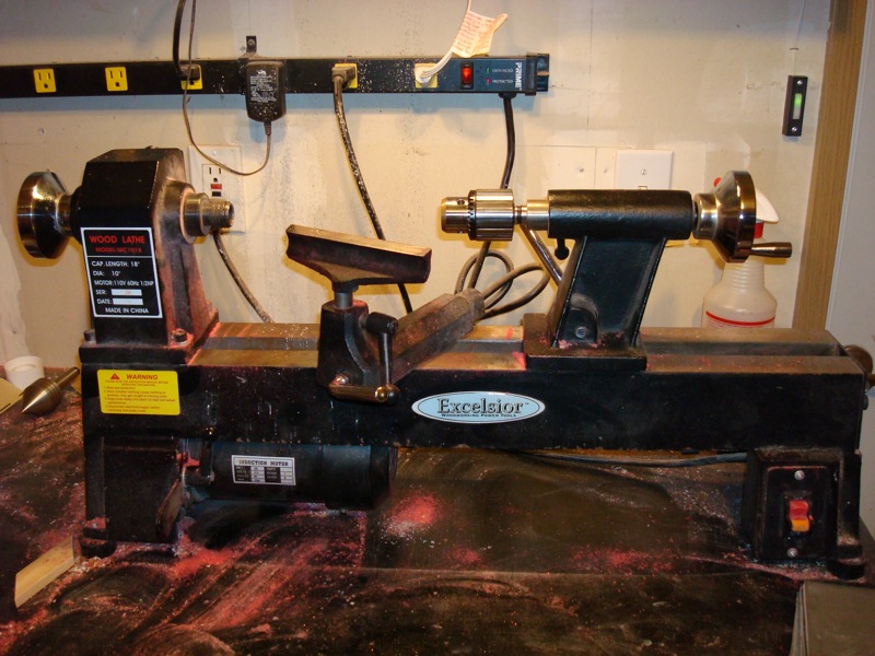

The thing that I charitably call a drill press has gone up in smoke. It was never that good to start with. I don't have a lot of space and am going to try drilling on my lathe.
Question, I have a tight budget. What kind of a chuck do you have and what do you like about it and don't like about it? Do I need an adapter? PSI has a set of jaws for their brand of chucks that are 2" long to support the blank as you drill. Is that a good thing or just creating a solution to an issue that doesn't exist? The 2 ends of the lathe line up fairly well, at the end of the mandrel it is only off by about a degree at the tail stock sometimes spot on. I will in time be using it for other things. Any advise?

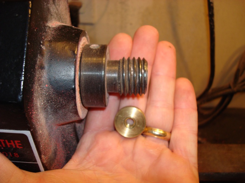

Am I correct in assuming that the threads on my lathe are 1"X8? It is a Rockler lathe and the post is about 1" measureing from the outside of the threads.
It's probably 1"x8. You've already verified the 1" diameter. The "8" is the number of threads per inch of length. You can verify this by holding a ruler or tape measure against the threads and counting the number of threads in an inch.
This is an important piece of information -- and a trip to a good (wide selection) hardware store should let you purchase a standard nut threaded 1 by 8 threads for a buck or so. If it goes onto the lathe headstock smoothly, you confirm the threads.
Odds are that is the case, but there are a bunch of odd threads around on headstocks.
the manual for the lathe will tell you the threads also.....

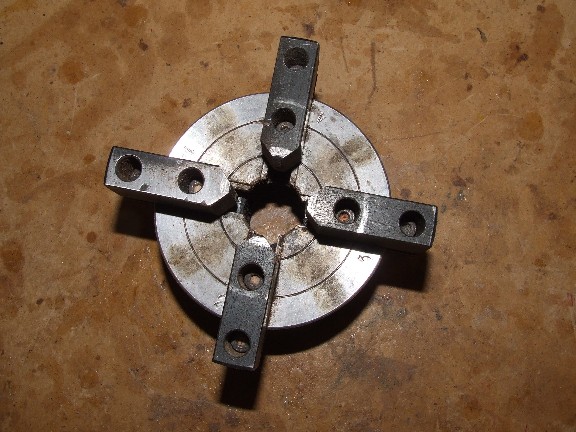

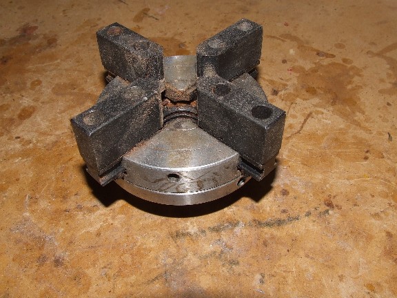

I use a PSI mini chuck..cmg3 I think is the model number... it has four different sets of jaws and one of them is a set of small bars that will hold about any pen blank I want... it's just a matter of lining up the blank between the drill point and the chuck jaws before I tighten the jaws...
The pin jaws you mentioned will work as well... as long as they will close tight enough around your blank... I drill my blanks in the square... I don't round them until after they are drilled... that way if I'm off slightly, I can still get a concentric pen body by turning around the hole rather than trying to get the hold through the center of a round blank... just my way, not necessarily THE way. I turn between centers on my pens, so the blanks will come out round on the tubes.
