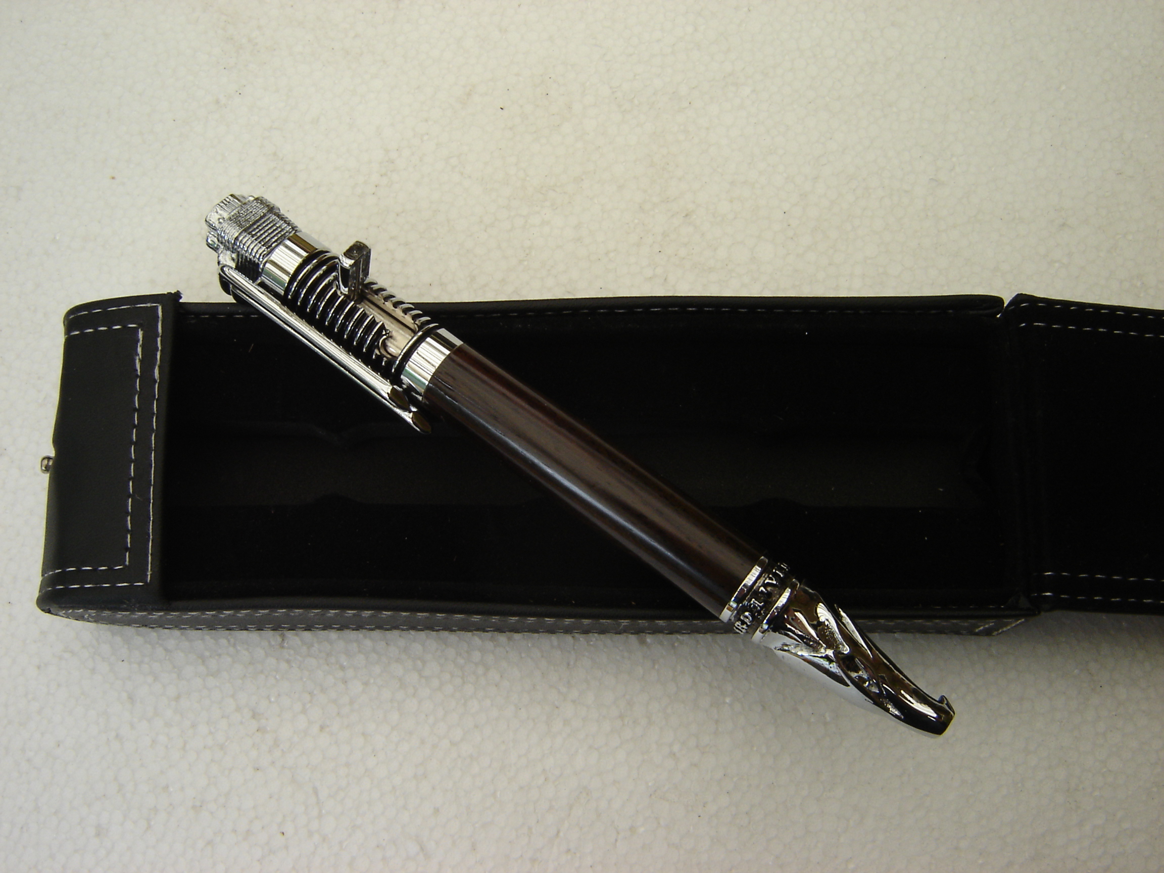

The Motorcycle Kit from PSI, is one of the easiest Kits to assemble, it is of Superb Quality, and Striking Appearance.
To start with it uses a 3/8" Drill for the Blank.
It has, apart from the Refill, and the Spring, 3 parts to add to the Blank .
The Head Unit, contains the profile of the Single Cylinder Motor, a Shock Absorber, it has a Kick Start Pedal that operates the refill, and the Twin Exhaust Pipes are the Clip.
The other two parts you fit are the Threaded Coupler, and the Nose Cone.
This vision of a "One Lunger"(One Cylinder) Motor Cycle, brought back to mind, many of the Post War, Single Cylinder, English Motor Cycles, such as the "AJS", the Matchless, the Vincent Velocet and Triumph, just to name a few.
Many of these Stood out with their Frame, Fuel Tank, Mud Guards, etc, were Painted Black, and had Chrome, and Polished Aluminium.
This image, led me to use Southeast Asian Ebony, for the Body.
It was beautiful to turn with the Roughing Gouge, and Skew.
I then Finish, from 180 to 500 Abranet.
Then through the grades of Micro Mesh, all on the bare Ebony, after which I gave it 2 coats of CA, and after each coat, gave a complete series of Micro Mesh.
Finally, to finish, I gave a coat of Renaissance Wax.
This Southeast Asian Ebony, is a very Fatty Wood, the Gouge and Skew, peeled off the cuttings, like you could peel Butter from the Tub, it also was Susceptible and Burnished very easily, to a smooth and closed grain surface.
I will be building more of these; I think there is a definite Market, not only among the "Bikie Fraternity", but the independent and casual Motorcycle Owners.
Your Critique, and Comments are always welcome,

Very nice pen Brian. Thanks for your review. Your finish process sounds interesting. It shows good results. The fit is dead on in my opinion.

Wrong Diameter Drill Given.
My kits from PSI say 10mm?? Philip
Thanks Philip, You are correct, :good: the Diameter of the Drill is 10mm, and not 3/8" as I quoted.
The Pens Instructions are so easy that I didn't bother filing the Instructions, after I built it, and when I posted the Pen, I knew that it was a popular size, and I wrongly thought it was 3/8". My Goof. :redface:
Thanks for noticing and putting me straight, well caught. :eek: :highfive:

Brian, first off, congrats on the cover shot. It's well deserved and you have made many pens that could have made it, so please don't sell yourself short. :wink: You are also very kind with your complements to others, so it couldn't have happened to a nicer guy. :)
Please permit me to comment on the kit itself.
I really like the concept and think the top half is pretty cool. I'm afraid the idea around the style of the nib eludes me. :confused: It appears to have a hook on it and a twisted style. I don't get it. If you or anyone else knows what it represents, then please let me know.
It looks like they have incorporated an 'old school' bike pedal which is nice but then mixed it with a rifle bolt action.
I think they may have been better of by perhaps using an old style kick starter pedal in the clip and then had a twist or click mech. :wink:

Thank You Steven, for your very kind words and support.
It is most gratifying to receive such comments and remarks, from a Pen Maker of your standing, and to realise that ones own small contribution to the Association, is well received and appreciated, by so many members of long standing, and experience, and who's contributions are magnificent and legendary.
I share your remark as to the significance of the Hooked, Eagle Nose Cone. All I could come up with was:
"Could it be in reference to the Early Bike Riding Groups, in the days before Bikies wearing their leathers and colours of their various Bike Clubs, and be a General Tribute to "The American Eagle""?
I also winced at the Kiddies Tricycle Pedal for the Kick Start Pedal, in particular being fixed, and obviously the wrong Style and Shape, But I can appreciate that if they were to make the Pedal a fold up Bar style, that would involve additional components, and the Fold Up and Spring, could become a weakness in the Pen operation.
Even accepting those points I did enjoy making a pen with the Kit, and I was very pleased with the end result.
