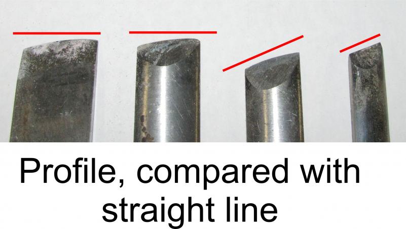

Ok, let's start with "why this profile"?
Cause I don't CARE what the profile is!! Turning a pen is a straight cut--no beads, no coves, no talent required!! Just cut straight.
SO, my skews are pictured below:

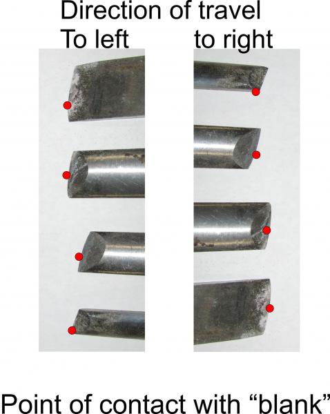

WHY don't I care?
BECAUSE EVERY angle has a sweet spot or two for cutting. The red dot shows where I think I will get the best cut on the edge of each skew, making a pass going left (first pic) or right (second pic)
