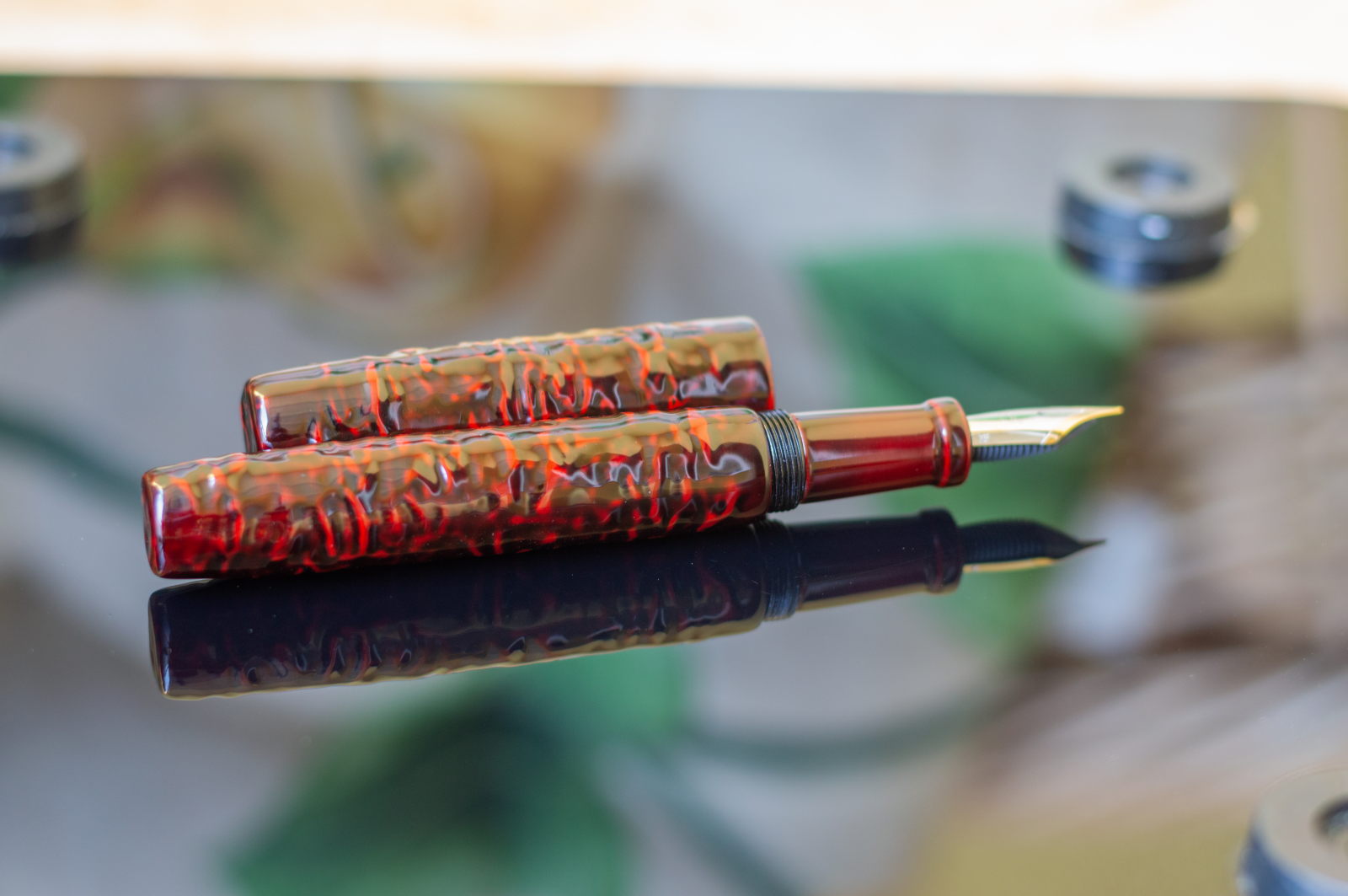

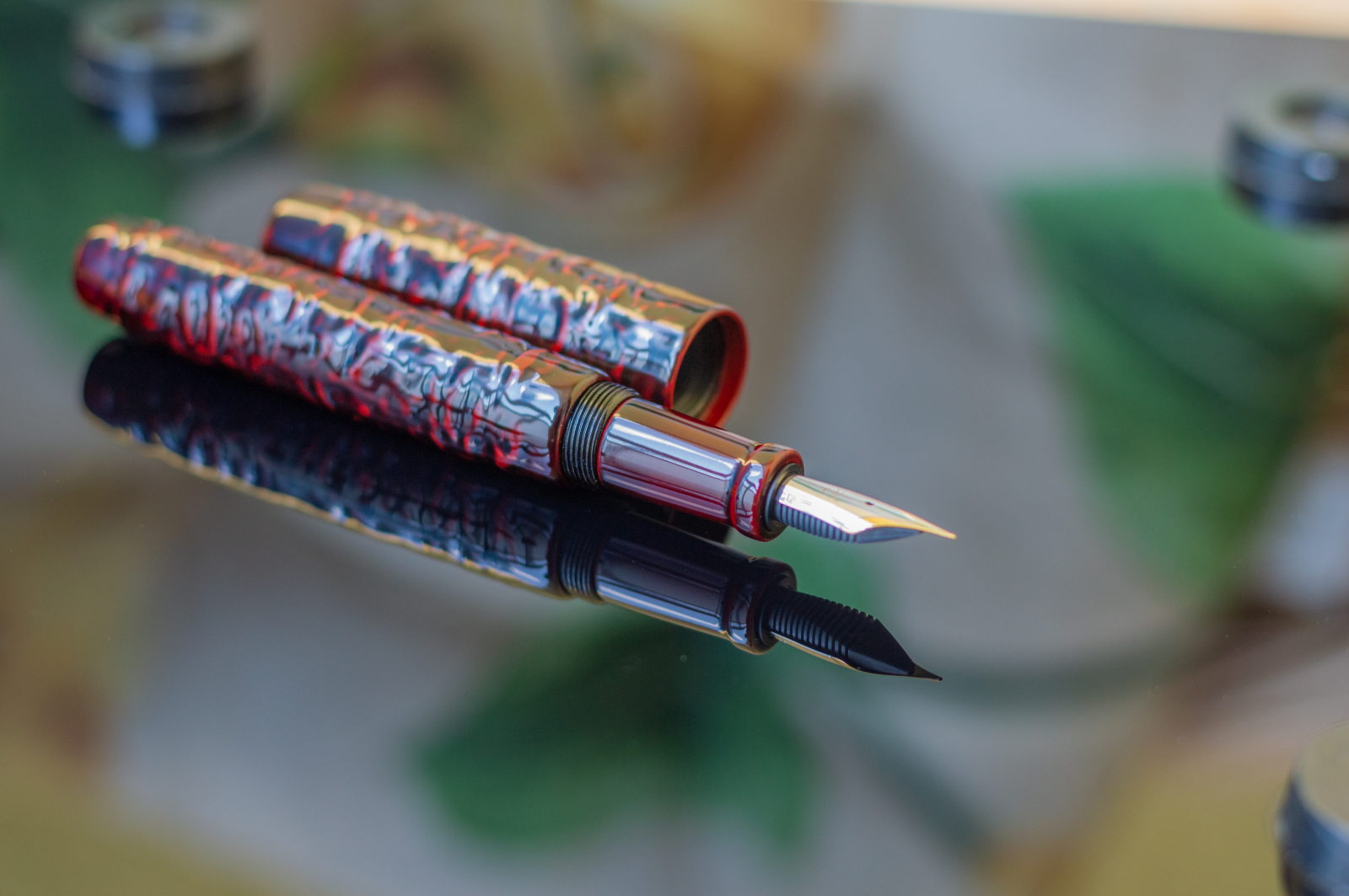

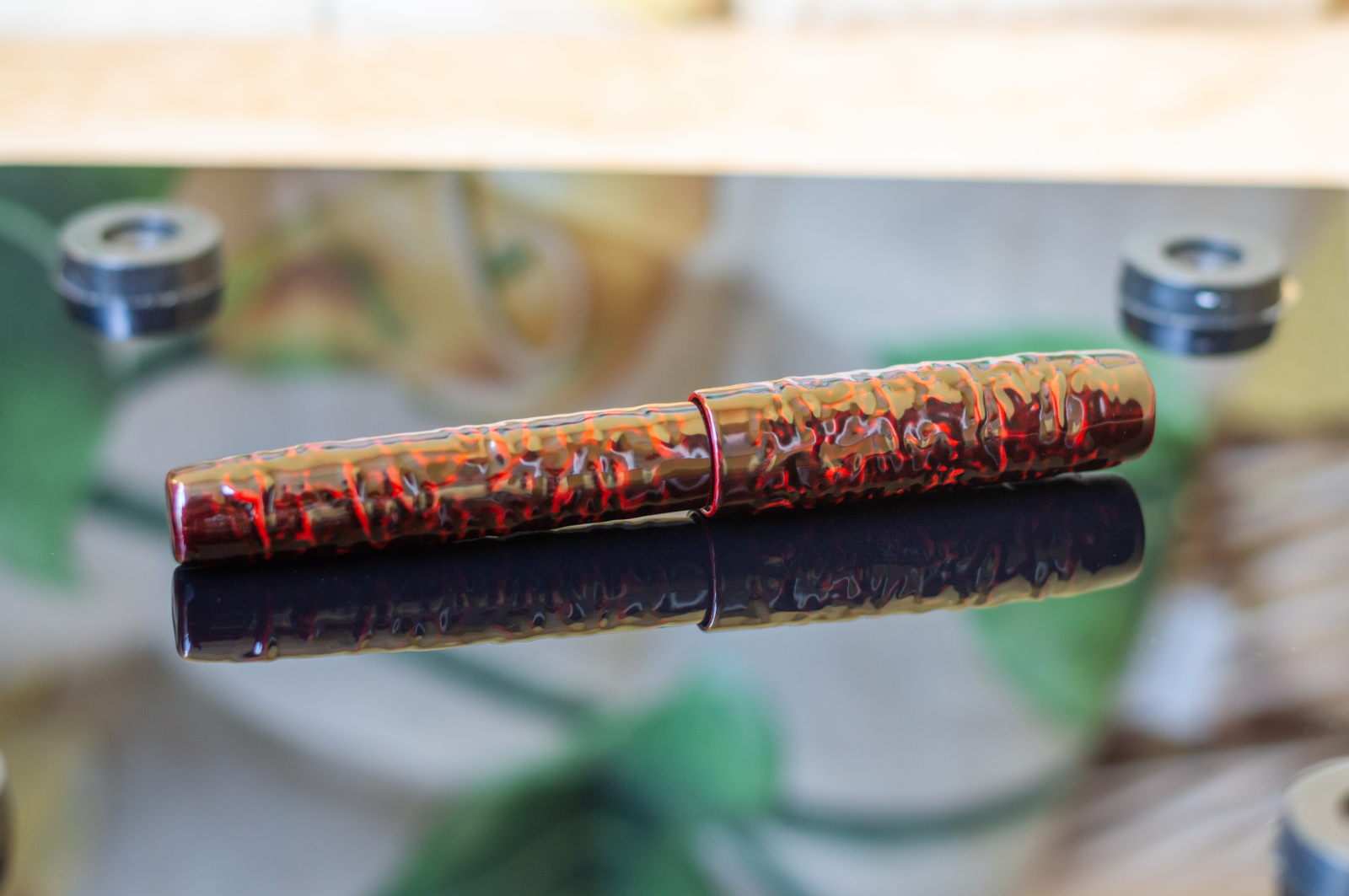

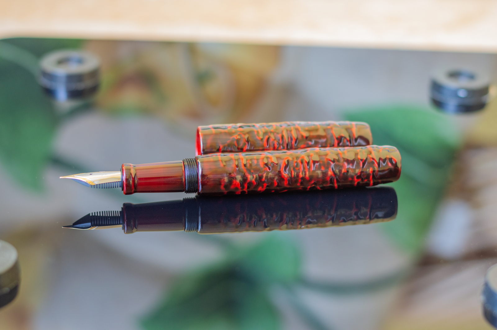

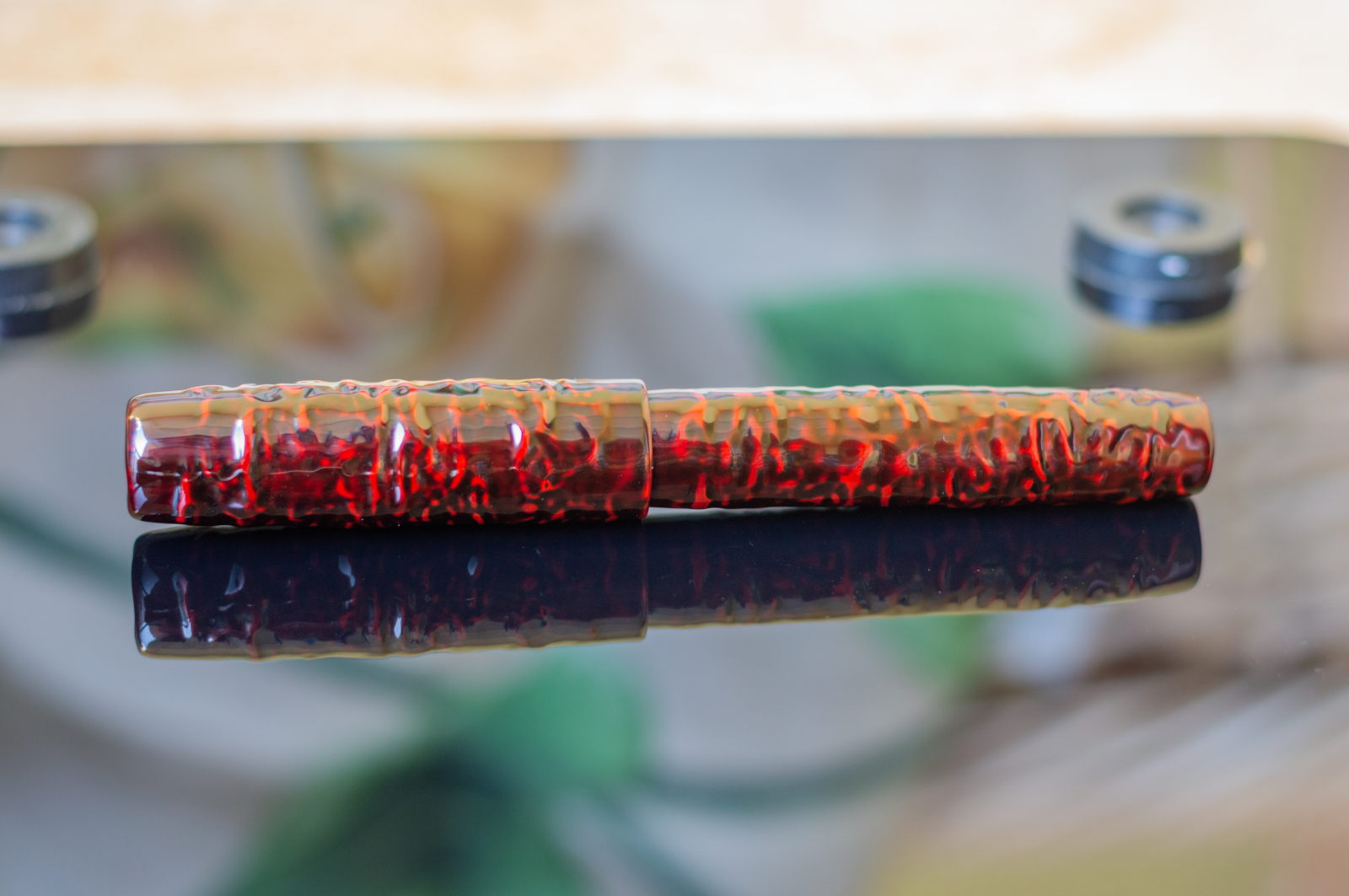

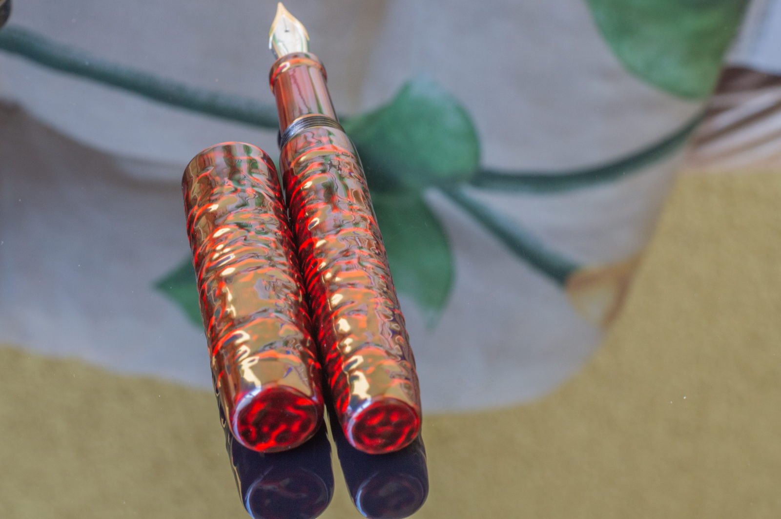

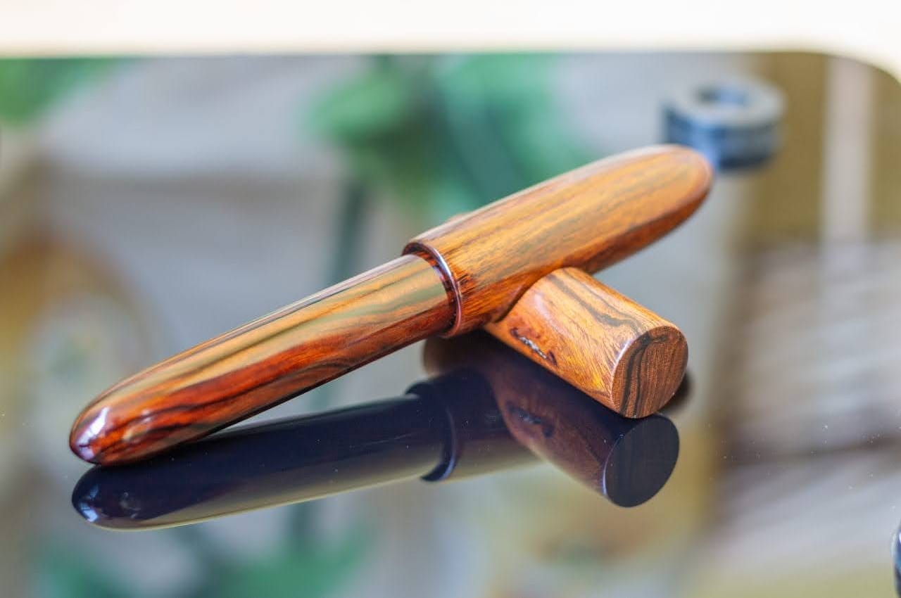

Hello Everyone,
A different version of the cherry tree bark lacquer finish.
The pattern is made with sabi neri, mix of urushi and earth. I lost count of how much work was required but it was long, the layer of sabi neri took several weeks to cure.

Teodore, that is a beautiful work of art! Rarely did I see that kind of detail in except in museums when I lived in Japan. Stunning!

Exquisitely interesting finish !!!!!
Very well done, Teodor !!!!!
Question ..... How do you know when the curing is "complete" when the process takes so long ?

I think I would be afraid to touch it. Again excellent work I think you should try CA finishing wearing a blindfold and one hand tied behind your back.
Great work.

Simply incredible. One question I have (and you may have covered this when showing one of your previous works of art) is how you get the threads on the body for the cap so clean. What do you use to cut them. Thanks for sharing.

I must say I would not call it a cherry bark pen. 😊 But it doesn't matter, it's a great great pen anyway. Wow!
I wonder too about your perfect shiny threads. I guess you urushied them, but then? Rotary brush with compound? Disks? Sanding? Filing?

Thanks. I made them by hand, triple start die from Tapco. I prepare the tenon like finish product, sanded smooth, I sand the edges. I use taping oil nd go slowly. After taping a sand again.

Well it took me a lot of work and trials to make them. I can say only that I use japanese urushi for the threads, out of the box process to paint them and a lot of time, one note, dust free environement.
