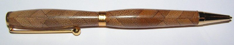

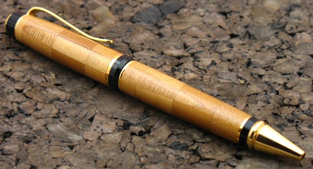

Thanks and, no, I didn't have any issues with it when I was turning. I was kind of surprised that I didn't. I treated it a lot like an acrylic and turned really fast and used a light scraping cut and it came off in ribbons. I was a little worried the glue joints wouldn't hold, but they didn't give me any problems.
I've found that bamboo turns quite well, there is a chance of tear out on pieces that thin, but for the most part it turns just like any wood. I've done quite a few peices, and I've seen very little tearout with bamboo. I would however recommend that when gluing the blank to the tubes, you be extra careful about getting good glue coverage.
I've seen splitting of the blank when thin to be more of a problem than tear out. I think this is due to the fact that bamboo is really a grass, rather than a tree, or so I've been told.
