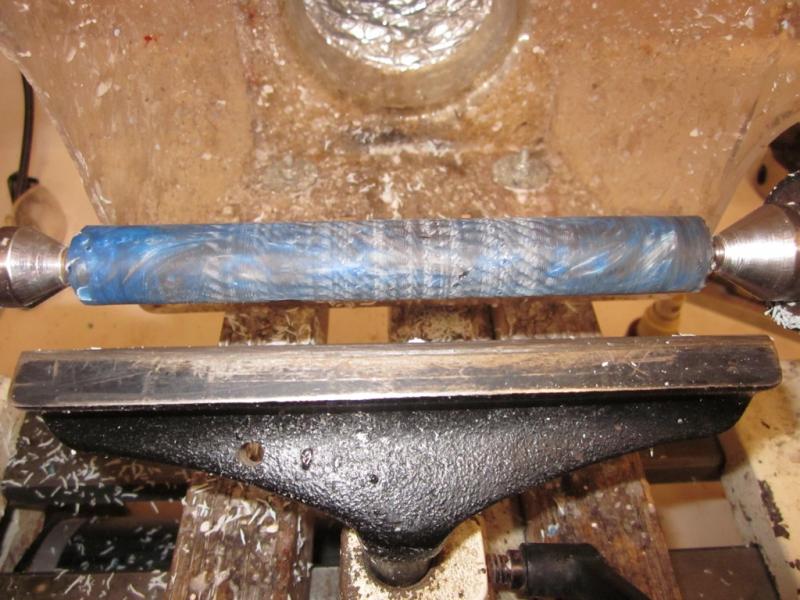

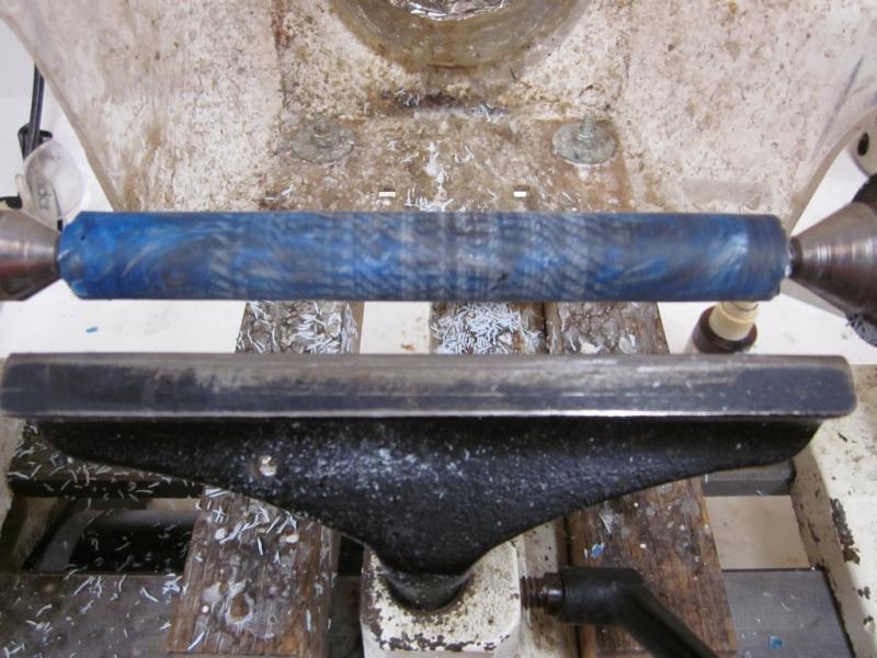

OK guys, hopefully you can help me out here. I am starting to have issues with chatter in the center of full-length blanks. The latest round was really frustrating. I was trying to round out one of my recent cast blanks and the chatter was worse than ever. The blank was 5.25 long. As you can see from the photos the ends are fine, but the center has extreme chatter marks. It was so bad that it was causing chip-out in the blank.
I have tried the bowl gouge, spindle gouge, scraper, skew (all sharpened to the best of my ability) and even my woodchuck pen pro with a fresh edge. I've tried sharp angles, shallow angles, light cuts and heavy cuts. Nothing makes a difference.

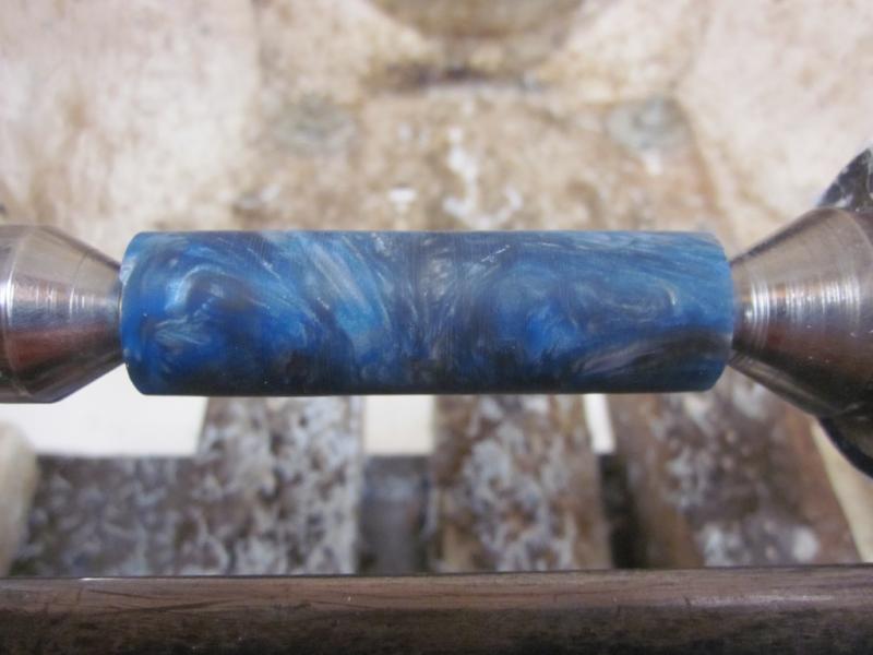

As you can see in the last picture, a half-blank turns nice and smooth but that doesn't help me out when I want to turn a Zen or Long-click.
BTW, this happens with wood as well, just not quite as noticable. Any ideas????

Move your toolrest closer. Is there any flex? Where does your tool touch the blank?

Maybe a much lighter touch in the middle? the ends have support that keep the blank from flexing, the middles have no support. Even a tiny flex could cause this.

I have this happen all the time. I think when you/me are turning a blank from square to round the ends cannot move but the center flexes. This happens on fresher blanks for me usually. I do also think pressure from the tail stock may bow it also. You might try using your skew holding it firm so it does not bounce in and out every time you hit peaks and valley`s .

Thanks for all the suggestions. A few things: I've tried the tool rest at multiple distances with no luck. Also, as for light cuts, if they were any lighter I wouldn't be touching the blank! I was cutting so light that what was coming off could barely be considered "fuzz".
My vote for most likely suggestion is too much tail stock pressure. I am cranking it pretty good to keep the blank spinning when I put the tool to it. I'll try another blank tomorrow and see if I can get better results.

I believe the problem comes from the tail stock being too tight. I may not make any difference with a short blank but long blanks, will most certainly force the blank to bounce due to the slight curve the over tight tail stock causes.
The reason why most are having this same problem is due to the fact that, the TBC live and dead 60° centers, made with the harden and polished steal, doesn't have much "grip" to make the brass tubes glued in the blanks, to spin "firmly" with only a light touch that becomes a lot more an issue the longer the blank is so, the first reaction is to put some extra pressure in the tail stock. That is what is causing the problem...!
There will be many ways one could add something to the live center cone to increase the grip and not compromising accuracy, I use an O'ring (various sizes depending of the brass tube size) on the live center tip, there is, where the brass tube and the cone meet. The O'ring has to be the correct size to work, in this case, the O'ring diameter is about the size of the brass tube diameter. You know when you've got the correct size when you insert the O'ring on the live center cone tip and bring the blank, already with the brass tube glued and with the gentle hand pressure you see the O'ring ALMOST go inside the tube, as due to the conical shape of the live center, by the time you bring the tail stock to the other side of the blank, a very gentle pressure is all you need to get the O'ring to lock in the brass tube, making a gentle but firm grip to turn without spinning...!
This stops any center wobbling on the center of longer blanks, well, it did to me...!

George did a good job of explaining what the problem is. The 60 degree TBC live center doesn't create enough friction on it's own to keep the blank spinning so I was putting too much pressure on the tailstock to create friction on the live center.
I'm thinking this might be a good solution.
