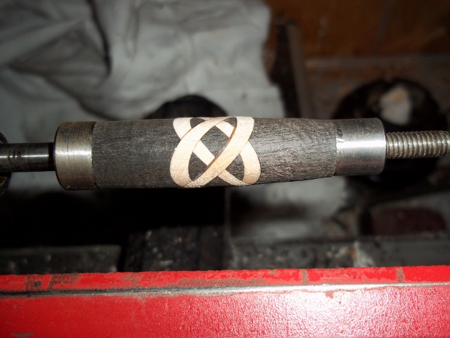

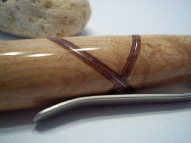

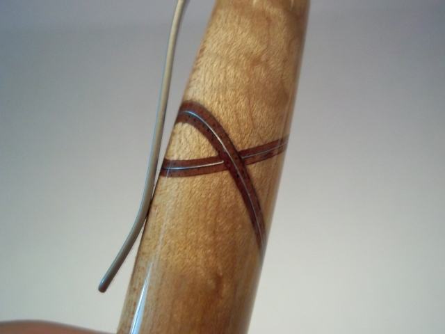

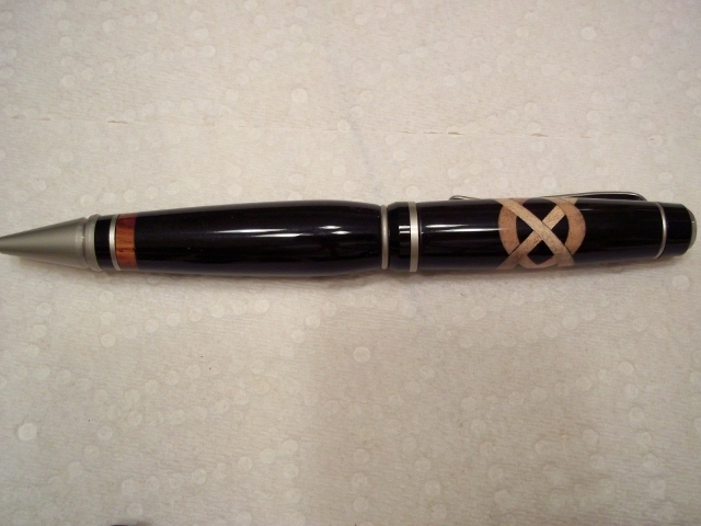

i have used both methods and will provide proof for both.
1. not sawing through the blank makes it easier but just marginally. it is a little easier to keep everything aligned, but matching the material to the kerf is tough. and if it is not right the blank starts to twist.
2. cutting through the blank is my preferred method because it allows you to use any sized material. and when using c.a glue to assemble it is incredibly fast and once glued it is just like a solid piece of wood again.
bottom line. do what works for you. try both and see what you like. in the pictures attached. the mahogany in african ebony was NOT cut through and the walnut and aluminum in maple was cut through. especially handy when inlaying layers because the thickness doesn't matter.
