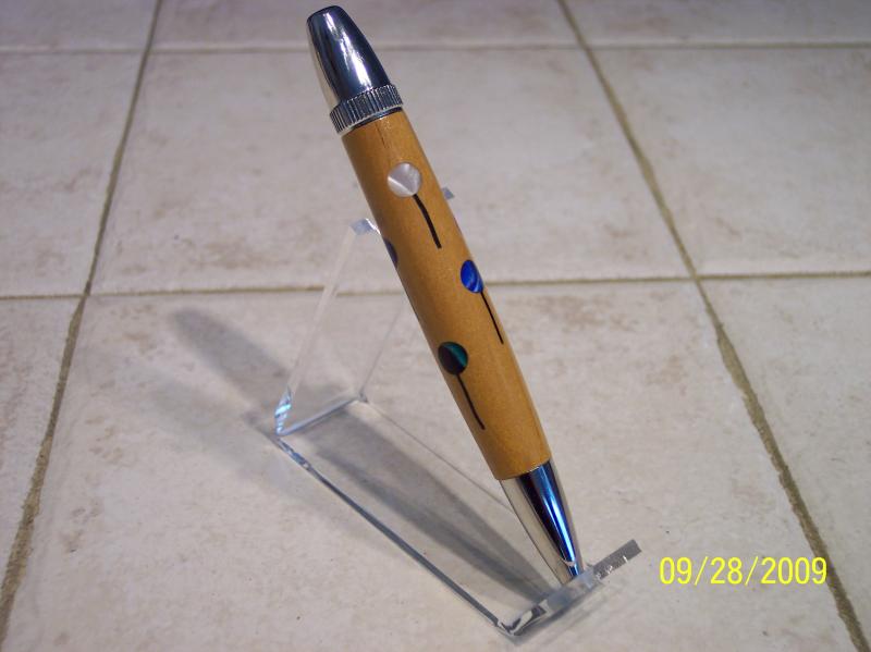

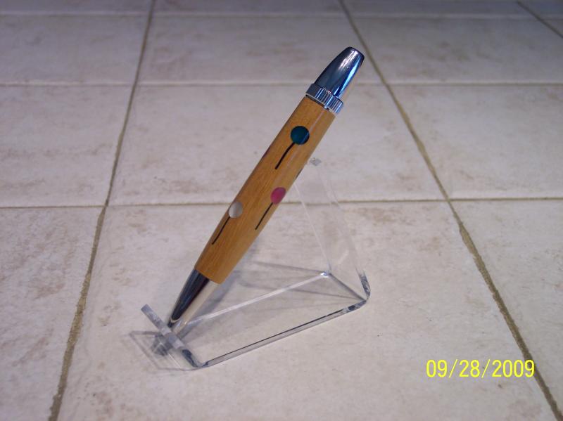

Here is a couple of pic of a pen I did for one of our local radio celebs. She recently had a baby so I tried to come up with somethig fitting the occasion. This is actually the first one I made and ended up with a slight crack in it. I repaired it with trust ole CA but decided to keep it and make another one for the gift..
It's a Chrome Atlas made from orange asage with 8 ballons made from varying acrylics.
Sorry for the sucky picture quality. Just not a camera person I guess
Thanks for looking and comments are always welcome...

Mike the strings are just black veneer... Since I drilled the holes for the balloons completely thru the blank I used the scroll saw the cut the line for the string then just glued a piece of black veneer in place.
