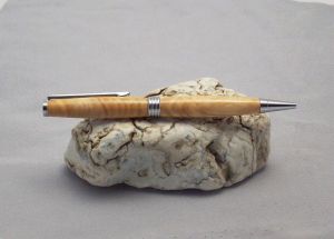

I have to disagree. Air dried, yes the slab had cracks but just cut blanks around them.

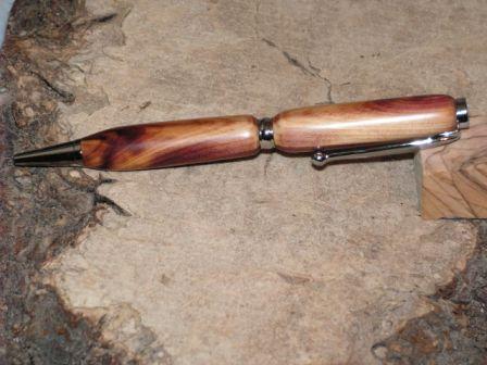

I have made several dozen pens from natural dried cedar with no problems. I agree that if you have a blank with knots, use it, it will be awesome. The dark purple color looks great. I apply 5 coats of med CA ad have never had a complaint about it being soft. Here is an example of one I did. The cedar I use is from a tree that was cut down abou ttwo years ago and dried naturally. I cut it into logs and use the whole log to make slabs when I need some.

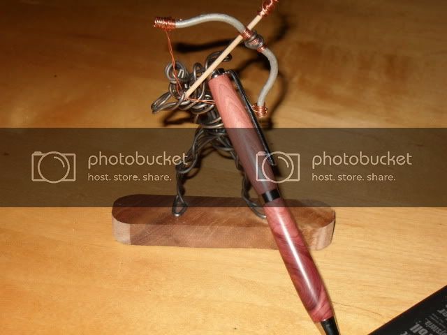

here you go, made this a couple weeks ago, still smelled after 6 coats of CA, and the customer LOVES that:) which is the whole point right?
it was actually a trade for the wire figure in the backround, which i had custom ordered

Wow, that was a fair trade! Cool figure.
I especially love it when you can get the knot in the wood- very nice pen.
