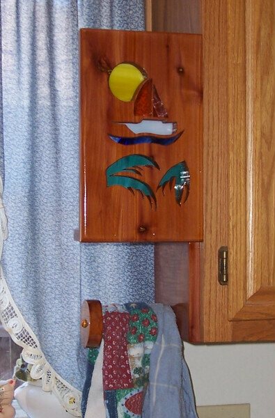

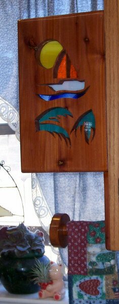

Richard, I did find a pic of something else I made from the cedar dog-ear planks. It's a paper-towel / dish towel rack. It faces the sun going down from spring thru fall, looks better than the pics!!!

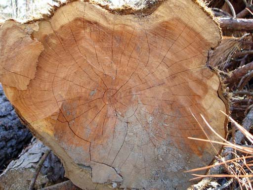

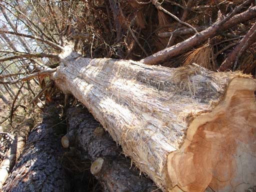

Here's 2 pics as promised:
Not the best pictures, but the sun was in my eyes.:D Can anyone tell what kind of cedar this is? Oh, this tree was damaged by a recent storm, and due to a long drought we've been under, it just wasn't going to make it.

Can't be sure what type it is from the picture, but it looks like eastern red cedar. If you want to pay the expenses, I'll come down and turn it into blocks for you with my chainsaw and even give you some free lessons in using one. When we sell firewood around here, we make sure that there is no pine or cedar in the pile, customers complain about it because it will cause excess creosote build up in the chimneys. It sure is good for fires on camping trips though.

It looks like eastern red cedar and those small limbs are the best pen wood in the tree. You might try a few of those dead pine limbs too, if you get into the knot just right they can have a lot of character and the pine knots are tough.

Looks like eastern red. Does it smell nice? The 'aroma' deters insects but can be tough on the throat and sinuses when working. Despite what others say, it has little value. Do try to work it. East to turn, but, as I said, it is brittle. Expect blow-outs.

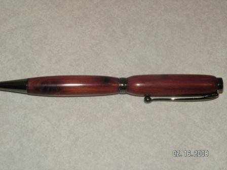

The first pens and pencils I made were from eastern red cedar, still have both of them, sometime there will be a variegation of red and yellow and nearly purple in the heartwood, it can be beautiful, also the limbs do have some interesting growth patterns, plus it smell so good. :D
