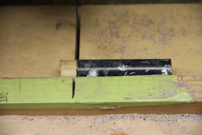

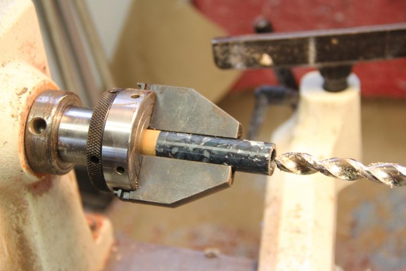

drilling Ceblox
:usflag:Drill on lathe. Slow speed, sharp bits, take your time. OkMan's thoughts on water for lube and cooling are right on.
Ceblox being expensive, I hate to waste any of it by cutting extra long then cutting it off after drilling almost all the way through. Alternative is to CA on a backer block. Pictures show piece I did today. All I did was add a piece of standard dowel rod. This will prevent blowout. Then just cut the backer block off. I will do the same thing on TruStone. With this methodology I have been successful drilling a 3/4" sq. TS blank for a Majestic. Ever wonder what to do with all those little cut-off pieces left over when cuting blanks? Mine go into a box on the small bandsaw stand. Use them for backers or segmentation work.:cool:
