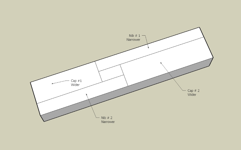

Eric; I have ripped two baron blanks for a pen set from one of Ed's blanks. It takes some careful cutting on a band saw and using a narrow blade but it can be done and it isn't noticeable unless you are going to do a no-center-bank pen. This is just a quick photo and isn't to scale...

First I have seen this thread, spent all day yesterday turning!!! That was fun, it's been a while!!
Now, first, you should have gotten a sheet with that "Catcutting 101" that gives my simple answer. If you did not get it, PM me your email address and I will email you one.
VERY simple answer, you can cut dead center and get two barons out. SOME have cut dead center and got two Jr. Gent. I have gotten ONE, blew up my second. But, cut a little OFF center and a Jr. Gent and any 7mm pen should be easy.
