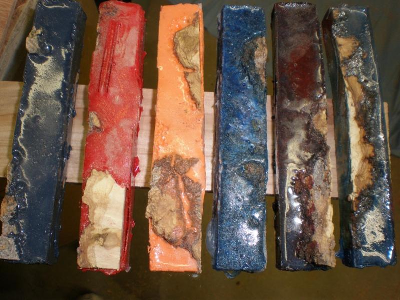

Hey! I just stumbled upon loads and loads of powdered paint, mostly "tempera" of all different colors and i was wondering if this stuff works as a suitable dye. I also found some "Glass Metallics" that range from black to white and coarse to fine and was wondering if this stuff weakened pr at all, specifically michaels cc? Thanks!
Jmhoff10500
Nov 11, 2009
869
Provo, Utah
Just in case you guys were wondering, it does work as a dye, but i haven't turned the blanks so i don't know of any residual affects...

thanks for posting! I have turned 2 test ones so far and they have turned out great! the colors are much deeper and richer than the testors paint i have recently used...

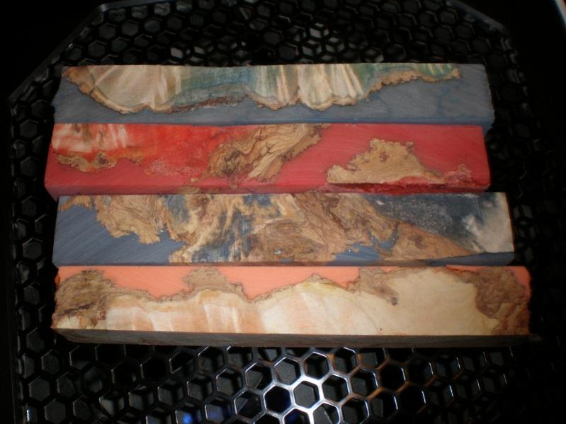

no pics you didn't cast anything:rolleyes:
My last batch... Just remember that they are in rough form and until i get a new sanding pad for my sander, they probably wont look very good... Thanks!

Yeah! they are mostly all just one piece of wood and i wanted to get the cross grain contrast between the sapwood and the bark. Thanks for the comment!
