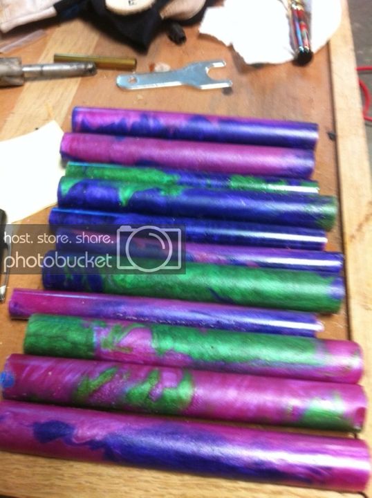

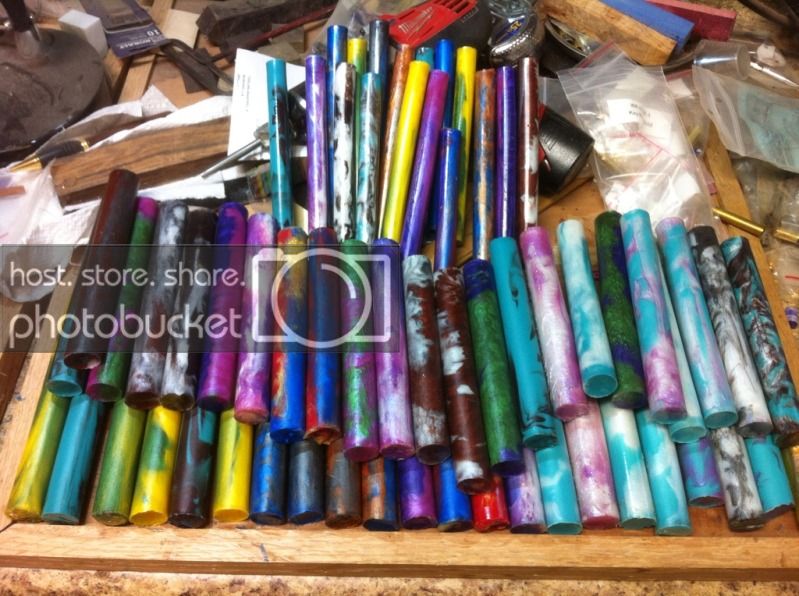

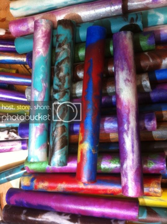

I have been asked to do a demo on casting pen blanks. It is my 2nd time being the speaker type guy. I learned what little I know from Jonathon Brooks, still not to his level of casting. I figured I better get into practice again as I have been without resin for about a month. Here is what I have done so far this week. Comments and critiques are welcome and thanks for looking.

I have a few more color combos to get done. Then I will start on the gold leaf ones. I need to wrap a few tubes to cast also. Gotta have time to get me all done. 2 demos to do and 2-3 shows by November. I think I might be busy for a few days.
