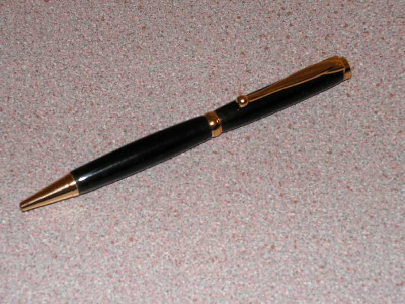

Thanks for the advice guys. Yea I just turned my first cast into a slimline tonight. It was still sticky on the outside but hard on the inside. Turned out very nice.
What's that? You want a picture - hehe I know you all to well!
kf4knf
May 17, 2006
164
Denver, CO, USA.
Sorry this is not a real good picture of it...
