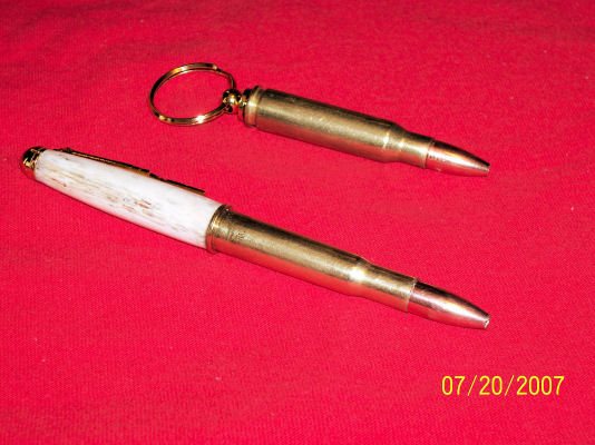

30-30 work good too. The keyring is a 308 and the pen is a 30-30
