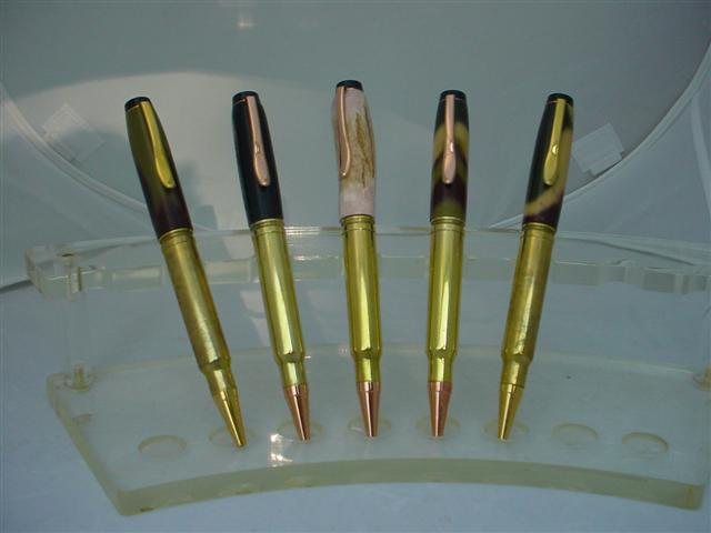

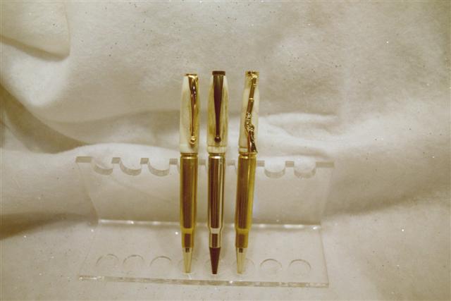

The two ends are done this way. Now, I am using a copper kit, making the nib appear similar to the normal copper color bullet.
OK, I GOOFED!!!! BIG TIME!!!!
The only way I know to "make it right" is to post the pic below and an explanation. The pens above were NOT made by me, however, I had them in my possession last year and made a poster about them for a friend. Some of you may know that friend as "Eagle". Hopefully, he is still a friend.
I have several pics of "bullet pens" and when I posted these, I grabbed what I thought was one of mine-it was NOT. The pens below ARE mine and they ARE the perfect fit from top to bottom.
Being the gentleman that he is, Eagle e-mailed me privately ASKING if the above pens were indeed mine. I appreciate his bringing it to my attention and I hope MOST of you will believe I was NOT trying to take credit for his work. Again, I AM sorry for misleading you (although unintentionally).
If there are questions, or you want a more thorough answer, I would be happy to respond in a separate thread (particularly if any moderators question my motives-I will be glad to respond)
Lastly, I thank Eagle for the way he brought this to my attention-in my opinion he is always a gentleman (sometimes fiery, but a gentleman)
