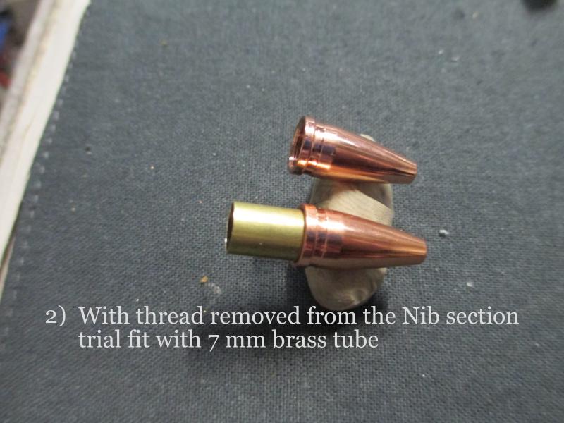

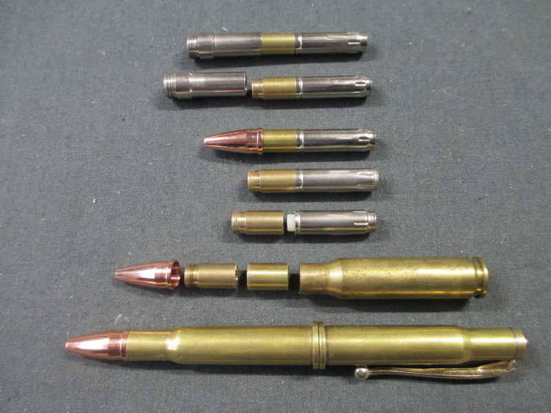

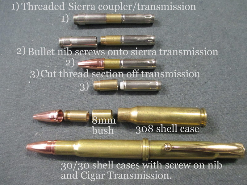

The thread from a threaded Sierra Transmission works, the thing is Sierra transmissions have threaded couplers and push on type couplers,i cut the tread section off the Trans and use that, sometimes i remove the nib end thread and glue a 7mm brass tube then make a bush to fit case neck. the 30/30 is to show the nib fit's this shell case also

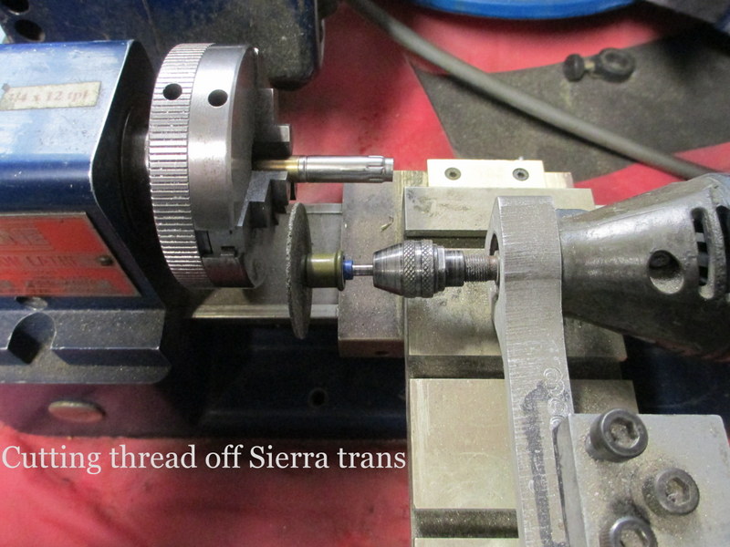

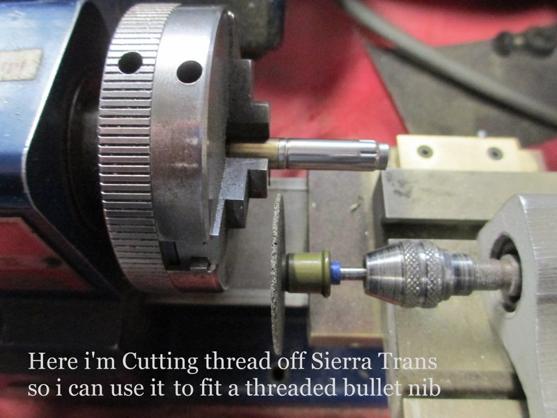

How i Removing the thread section from Transmission using chuck and dremel.Any chuck/lathe and handheld dremel would be fine.
