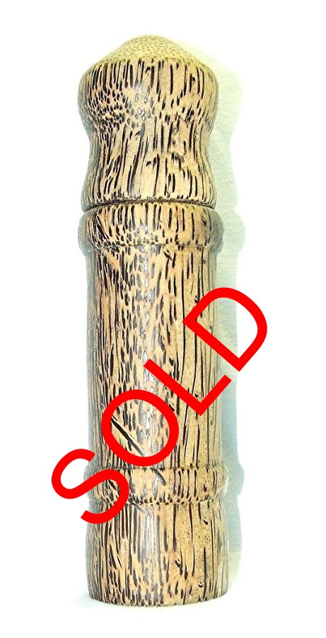

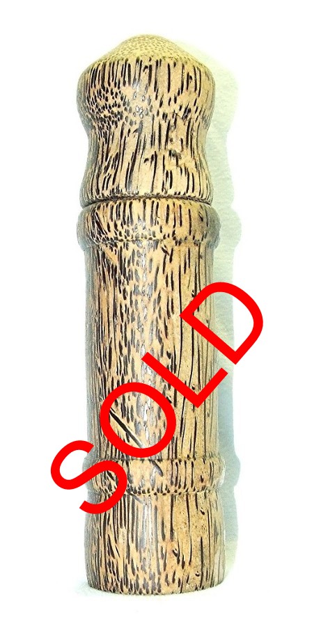

Sep 24, 2006
8,207
Tellico Plains, Tennessee, USA.
It's been a few years, 2004, I turned a pepper mill from Black Palm.... made an interesting mill and it sold the first time I showed it...
Thats a palm "leaf- branch" isnt it?
