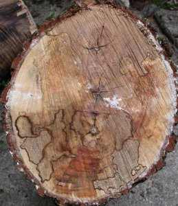

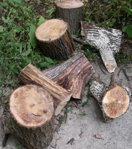

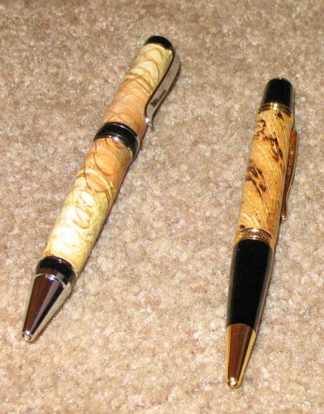

Here are some photos. The biggest one is about 8 or 9 inches in diameter, and about 12 inches long. (My friend chopped it up with firewood, not woodworking, in mind.)
I'm wondering if I should leave them out on the ground for a while for additional spalting. If there are one or two "threads" visible on the cut ends, is it likely there's not much spalting inside yet? If I do leave them out on the ground, is it better to have one of the cut ends down, or have them laying on their sides? Any idea how long to leave them out? (Mid-Atlantic coast region - pretty warm and humid this time of year)
And I know it's hard to tell from looking at rough logs, but if anyone has a guess on the species I'd love to hear it. (There were no leafy bits around to assist in identification.)

End checking at pith and radial splitting; better start doing something with that wood before critters and more rot gets it. Until you open up those log will never know how much usable wood you have. If you really want, more spalting just leave logs on the ground outside for another six months.

If you put them in a refuse bag on their own they will continue to spalt. Just check them regularly and turn the bag inside out every time you do so. You don't want them to go too far or it will become too punky to use
