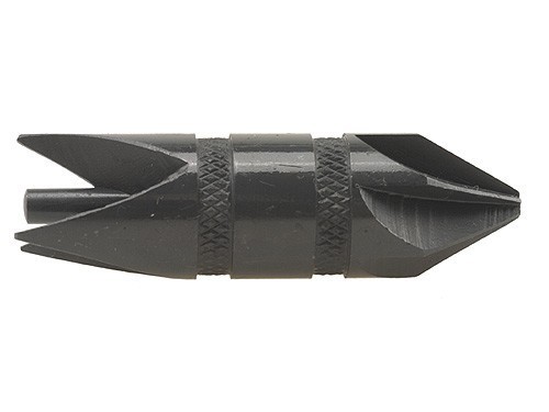

I suspect that you merely need to hit the ends of the tubes with a deburring tool. If you don't have one of these, you should get one:

Thanks for the quick suggestions - I actually deburred the tubes using the tool that Johnny CNC offers on his site - and also did try the sandpaper roll inside the tube. I sended them "Pretty" good and still will not fit.
These are REALLY tight - I am use to tight bushings using Johnnys cnc bushings exclusively now but this is WAY different then just a tight bushing.
