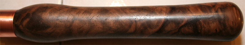

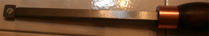

After getting a little inspiration from Bill (Wood Butcher) at the past couple Indy IAP meetings, and watching some videos by Captain Eddie on YouTube, I took a stab at making my own carbide tool. Here is what I came up with! It's made from 3/8 bar stock, a piece of a copper pipe coupler, and a handle made from what I think is Walnut (~30 year old wood given to me by Dad).
Sorry for the poor pictures - the photography area (AKA kitchen table) had to be cleared off for visitors over the weekend!

Great job!
I might be a little concerned about how much of the carbide tip over hangs the shaft. The carbide tips are brittle and can, and do, chip if you get a catch DAMHIK.

Thanks Andrew! I didn't think about the overhang as being possibly problematic. I'll wear my face shield and give it a good workout and see what happens. Joe's post linked below gives me a good place to pick up cheap replacements for the cutter. :biggrin:

I had a chance to test it out tonight - I'm very happy with how it turned out! First test was a cocobolo slim... piece of cake with this tool, and FAST. Second test was a PR blank. The carbide was slightly grabby when roughing the blank, but it was still a little faster than using my usual gouge/skew combo. I'm sure it'll get faster with practice, but it doesn't get easier than this! The 3/8" bar seemed to hold up well, and felt solid. I may try making my next one using 1/2" just for comparison's sake, but I wouldn't hesitate to build another with the 3/8".
My only other experience with a carbide tool was my very first pen that I made at the CSUSA booth at the Woodworking Show in 2011. At that time, I had a dull insert (according to the gentleman running the demo), and it was a very unpleasant experience. It's amazing how much difference a sharp insert has on my opinion of this tool! :biggrin:

Great looking tool and awsome wood in the handle that looks like figured walnut.
How long do you expect the tip (insert ? ) to keep sharp ? Can it be turned around and all four sides used one at a time as they get dull ?
Can they be sharpened in a home shop or are they throw aways when they are dull .
I do believe you will see a pleasant difference when you switch to 1/2" stock next time .

Thanks William! I'm pretty sure the handle is walnut. My dad doesn't think that's what the gentleman said it was when he initially stashed it away - but I agree with you and think it's walnut.
The insert can be rotated when a side gets dull. I don't know how many pens I can do with one insert. If anyone out there can speak to this, I'd be curious to hear! My guess is that I'll probably get 15-20 pens from one insert. You can sharpen them with a diamond stone when they get dull. However, you can buy them online for less than $2 apiece, so I may just stock up for now since I don't have a diamond stone.
I'm looking forward to trying a 1/2" bar on a future one. The only little drawback is that the 3/8" is pretty narrow, and if you're not cutting in the dead center of the insert it will want to tilt on you. It's very manageable, but something you have to think about when using it!

The ones from Global are straight across the cutting edge. They have a tendency to dig in, at least that's been my experience.
Cutters with a 2" or 4" rad. are much easier to use if you cut with the trailing edge of the cutter. They cost in the range of $6.00 - $7.00 ea.

Honestly, sometimes you might WANT that tilt. You might try a hex bar instead of square. I made one from round stock and I probably angle mine just as much as I hold it flat. Now, with a square bar I'm sure it's easier to keep the tool flat WHEN you WANT to, but you just just might find that you also WANT to hold it at an angle. Just something to think about...

I've rounded the edges of the bar slightly (when sanding), and it does make it very easy to tip on the side to make a skew-like cut. That is one advantage of the smaller bar (and why I intend to keep using this size, even if I do make a 1/2" tool).
inserts
Global makes the exact inserts that you linked to. The 4-inch radius BT inserts are $2.35 each when bought in a box of ten. The 2-inch radius ones are available from them, but are a special order item.
I'm definitely going to use a hex bar on my next one.
