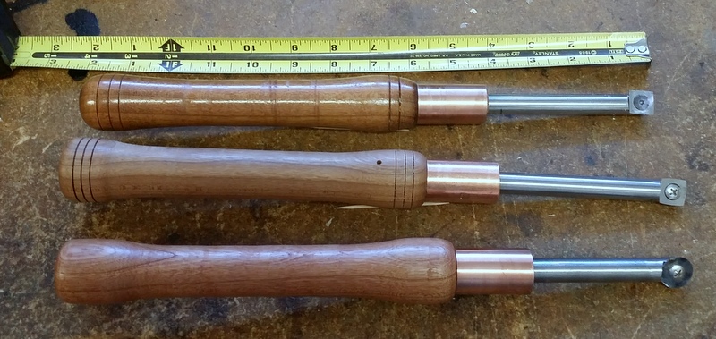

These are my homemade tools. I did not plan their length, they were just arbitrary. After the first one I just sort of repeated it. These are 1/2" dia. I happen to have lots of it and I prefer round over square. Square is Ok for scraping but when trying to cut shear like square is not so good because when turning the cutter on it's axis the corner does not slide over the tool rest very well. JMHO. My Easy Woods are square and I seldom use them. Besides Capn' Eddie inserts are much cheaper and just as good. Just another humble opinion. :>)
Rocky,
Thanks for the picture with the tape beside them for scale they look as good as any ones you would buy in the store. What size lathe do you use these on BTW? Do you turn any bowls and if so do you use these or a specialty tool?
Where did you find the 3/8 or 1/2 in bar stock?
Thanks again, hopefully someone else will post their thoughts.
Thanks again, hopefully someone else will post their thoughts.[/quote]
My lathe is just a small 10x16 midi lathe. I have not yet tried bowl turning, just pens, bottle stoppers and such. I have a large selection of steel having been a hobby machinist for lots of years. However, 3/8 and 1/2" steel is available at your local hardware and big box stores.
