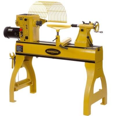

PS - note my new lathe!

I just noticed that Captain Kirk's jersey is just about the same shade as the Powermatic mustard yellow! :biggrin:
Great new lathe!....enjoy!
