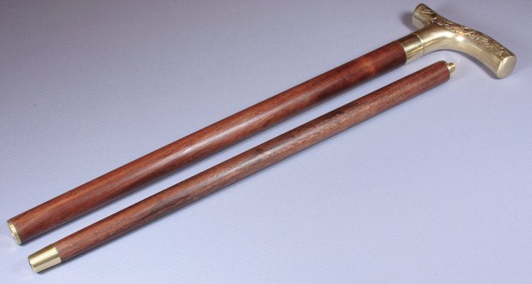

A while back, a friend brought me a cane kit that his father had purchased but never completed. So I turned a piece of his father's lumber and assembled it.

Originally posted by bradbn4
...how hard is it to attack the head to the cane? Can that design hold up to heavy use?
I'm not worried about the handle end. There are heavy brass ferrules at each end. The top one is threaded and screws into the cast brass handle. It is also threaded on the inside and screws onto a large tenon. The bottom ferrule is epoxied onto a tenon as well.
The weakest point of this cane (in my judgement) is the join in the middle. The brass fittings there are made to screw into the wood and the top one doesn't leave much wood for support. I didn't have matching taps and was afraid of splitting the wood, so I overbored the holes and epoxied the fittings in. On the upside, I think the epoxied joint is much stronger than a threaded one. It also allowed me to align the grain (and true the cane) more easily.
If I were to do it again, I think I'd drill, glue, and join the two sections first, and turn them together.
Regards,
Eric
