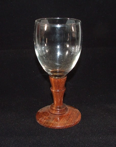

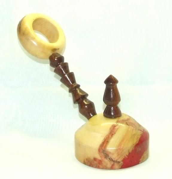

I haven't turned any candlesticks, but I do a number of goblets that are essentially some spindle turning with a base.... I make my stems by gluing a round "stem" into a flat base that is glued to a sacrificial waste block. The waste block has a tenon cut to fit in my #3 jaws and hold the "base" so I can cut it round. I've also cut the bases for my wine stands using a face plate with double stick tape holding the base in place while I turn and smooth it.
