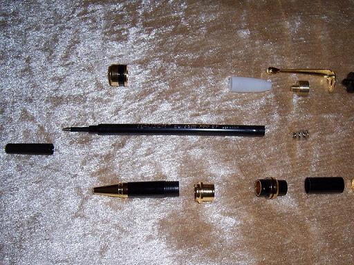

9/18/07 - I recently acquired about dozen pen kits, minus tubes. I was told that the kit used 10mm tubes, and have since purchased some 10mm tubes from WoodTurningz.com. When I received the tubes, I found that the diameter was too large. I decided to try 3/8†tubes, but find them to be too small. Does anyone have an idea where I can find tubes that will work with this kit?
I can not identify any sort of brand name for these kits. The only information I have about these kits calls them “Parker Style Rollerball†pens, and has a copyright date of 1994 by Thomas C. Hutchinson.
The measurement of the couplers and bushings all appear to be 9.0mm +/- 0.1mm

It's a CSUSA kit, you can tell by that stupid plastic snap coupler they use. My bushings measure 23/64" (or just a hair over 9mm)
The tubes are PN: 050-9160
BTW, save yourself now and just order the special "nib adjuster tool" they sell for the plastic cap, it is well worth the cost as you can damage the nib adjuster insert without it.

Berea also makes a snap cap rollerball, at least the last time I saw their catalog it was in there. If the refill says Hauser, it's more than likely Berea, if it says Schmidt, it is probably CSUSA. And, a #2 Phillips screwdriver can also be used to adjust the coupler.

I don't really know but the clue might be in the copyright. Check www.hutproducts.com. The <u>Hut</u>chison name might be the clue. Just a thought.

The easiest way to figure out if this is a CSUSA kit or a Berea/Hut kit is to look at the bushings. The Berea/Hut bushings are going to require a "B" mandrel and will be way loose on the 7mm mandrel used by CSUSA.
JimBob: If you don't already have a "B" mandrel, you better check your bushings. If they are "B" bushings, you better order a "B" mandrel along with those tubes or you will still have a problem!! Hut calls that mandrel the Ameroclassic mandrel.
