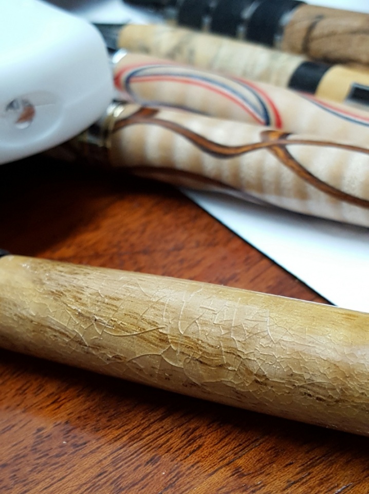

Yes CA good go bad. I don't keep an opened bottle longer than 6 months. This is a result of old CA.
