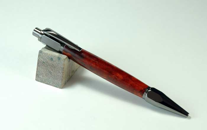

I have to go with the Vertex click from PSI. Very smooth and I have yet to have a problem with one.
