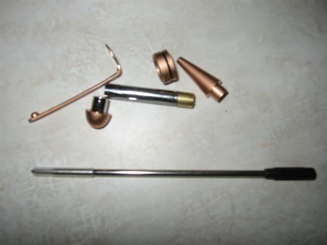

I have this pen kit that I know I posted a question about not too long ago, when I was trying to identify it. I had the bag labeled "gold top euro" and if my memory is working right, I think people said it was a Berea kit. Anyway, for some reason I am just having a heck of a hard time keeping straight who makes this kit, what bushings to use and everything else about how to finish a pen with it.
You can't see the tubes b/c they're in the 2 halves I've turned. It was 7mm tubing I'm pretty sure and they were 2 different lengths. I turned them using standard 7mm bushings, but I'm thinking that was a mistake. And even if that is right, I can't find instructions for assembly. (Side ?- does Berea not have a place on their website that they offer the instructions for their own kits???)
I'm also thinking this may be the kit that I had bought a set of the sleeved bushing for turning the tenon, but now I can't find those bushings, so if I need them, I can't do it anyway. I think what's confusing me is the different names that everyone uses, so I have kits labeled deco 7mm that look kind of like this, the few like this labeled gold top euro, those labeled slimline and of course 7mm. Is there an easy way to keep them all straight?

Looks like a 7mm Euro to me. Not the easiest to make due to the tenon but once you got it, it is a cinch. I think I turned 150 or so of these being my 2nd pen to turn next to slimlines.[:D]
Make sure you mic your tenon [;)] Some kits have the center band that exactly fits the brass tube...no tenon needed. Check your kit.
I know I got most of mine from Ernie at Beartoothwoods. Check his site for the instructions.
Here is a similar one from AS but this is for pencils...but very similar.
Good luck!

angboy,
What I believe you have there is a 7mm european pen in satin gold made by berea or Penn State Industries. It is tough to tell which, but the instructions are the same. If your bushings did not come with the sleeved part and you got the bushings from the same source as the pen kit then most likely it is from Penn State.
Here are instructions from woodcraft.com on how to make the pen.
http://www2.woodcraft.com/pdf/77B04.pdf
This pen does have a tenon, but if you do not have the sleeved bushing, you can measure the centerband and use calipers as the guage. I actually use the kit's centerband when I get close to make sure it fits properly. I have found that the sleeved bushings are not the same size as the centerbands. Just be careful and don't get the lathe tool too close to the centerband. [B)]
Good luck and enjoy!

Angela, is that copper or satin gold? I've not turned any of the 7mm Euros, but that is one and no you shouldn't have used the standard 7mm bushings. If it's a Berea kit, the twist mechanism looks just like the PSI Slimlines, but I haven't seen any PSI kit come with a protector on the refill. Sorry, but that's about all the help I can be. Not much in this case.

Hi this really looks like the 7mm european or "Designer" pen kit. There are bushing specifically for it, I got my bushings from Fritz @ WoodTurningz. He sold me this great middle bushing that has a locking sleeve that fits over the tenon after you turn it and gives you the accurate size without having to put the actual band on to get the correct size. He is really very helpful so all you need to do is call him for more of these kits with instructions and this bushing set.

JimQ hit it on the head with the directions. The bushings are PKMONT-BU and the sliding center bushing Janet mentioned is PKMONT-BUX. When you cut the tenon, if you make it 6/32 instead of the recommended 7/32, the lower tube will fit inside 1/32 and hide the joint making for a better final appearance IMHO.
If you've got your bushings in a bunch [:)]and can't id the right ones, I'll measure them for you in the AM. [;)]
Now just turn the wood off those tubes and start again.[:D]

Or assemble it as a modified slimline. Some people like the extra length. Then, either order new tubes for the euro or use slimline tubes to produce a shorter euro. I find the euro a bit top heavy anyway.

This is definitely the Berea kit, PSI soes not have satin gold or satin copper finish for their designer line. You mention that you have gold top euro, they uses the same busing. If you have labelled your busing, they woould be # 10A from Berea. I suspect that the PKMONT-BUX busing from PSI could work but i wouldn't bet more that 2 cents on it [:)]

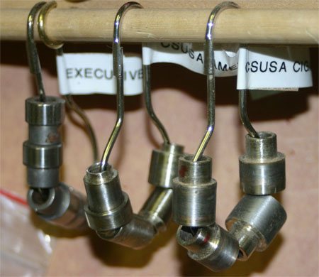

The discussion on keeping track of bushings comes up every once in a while. One of the best tips that I read was to thread the bushings on a shower curtain snap hook. The bushings stay together and are easy to identify by attaching a label to the the curtain ring. I'm don't recall who deserves credit for this one, but I think it is a really good ideal

I keep the bushings in the origional bags. Use a hole punch and attach them to a dowel on the wall with shower curtain rings. Different dowel for each maker. works great.

wudwrkr Dave Miller: Glad you like the idea. I tried lots of ways to keep the bushings and the shower curtain rings work best for me.
Randy: What a memory you have there Randy! I"ve kept different size faucet and plumbing washers on these curtain rings in my tool box for working on the family rent houses, and one day under a sink as I was taking the washers off the shower curtain ring it hit me....keep your bushing on these rings too. Someone else may have done it first...doesn't really matter, but I think it is a pretty nice way to keep them. The rod they hang on is one the edge of a shelt right in fromt of my lathe. I look up at the bushings and each one cries out, use me next, do me next, I tired of hanging here...[:D]

BTW Billy, the kit is satin copper.
So I guess I'll have to buy another set of bushings and sizing sleeve... Oh Fritz, [?] will you be at work on Monday?... I actually only have one half that is now in the sanding stages and that I'll have to figure out what to do with- I had already messed up one of the halves. So at this point, I'm thinking tit just wasn't in the stars for this pen to be made as I originally pictured it!
