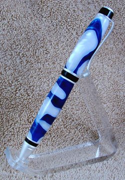

I picked up a new camera (Sony DSC H5). I also picked up a macro lens (VCL-M3358). A light tent and two high-output 5100K tungsten lamps. I made my own white, black and gray card. For the gray I just used red 200, green 200 and blue 200. I may need to get a professional gray card. The background is a tan terrycloth hand towel. I think the terrycloth being so busy, takes away from the pen. I want to make up some gradient sheets using Photoshop. It looks like a portion of the white on the upper part of the pen is a little washed out. The camera is set on A and I set the F-Stop at F8. I also set the focus at spot, maybe I should set it at center or multi, I don’t know which is better. The white balance is set at One Push. I set it when I had a white sheet in the tent. Is this OK or should I set it at Daylight, Fluorescent, Incandescent? I don’t really like the angle the pen sits at. I may cut the acrylic down so pens sit lower on it.
Let me know what to do, I need a lot of help.

Yes, the towel does make it look busy. Can't speak on the camera settings as I think things will change if you get an actual grey card. Sure helped me. As to the picture size, when you reduce the size, you reduce resolution. I think the one you posted is about 250x350, but near 100K. You need to raise the compression so when you save as a JPEG, the file gets compressed a bit more than it is. A picture that size should only need to be about 50k to get a good image and something abou 100k should give you almost a full screen.

Assistance, not criticism: Your white balance is off. Looks a little to blue. The towel is a little busy. I like the pen... [:)]

Tim, I don't have a good enough camera yet, so haven't spent much time with the photography end. But, I do like your pen. I agree the background does look a little busy.

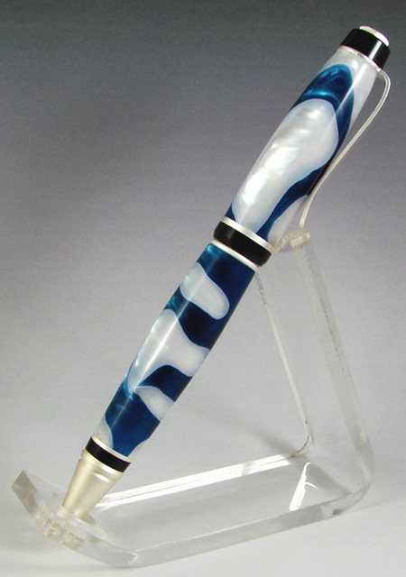

Changed the Background to gradient. Messed with white balance. Still don't know if I have that down yet. This camera has a One Push setting that you aim the camera at something white then take the picture. Thanks Mike, I did change the compression a bit to get a bigger picture that is under the 100kb limit.

Thanks for the comments from those who took the time to look. I'm still learning every day. I painted the tubes white.
Roy, in Photoshop when I crop the photo and apply the white and black color balances. Then I have the program show me Actual Pixels, it makes the pen picture huge. Then I just adjust the pixel width to 400 - 500, the height just changes automatically. Then during saving it has an Image Option slider that ranges from 0-12. I was saving at 12 before. I saved at 10 for the last picture. It just keeps the picture the same size, but reduces the quality a fraction, and takes up less kb's. I don't know if that is exactly called compression, but it's what I did to get the picture to stay big yet smaller kb's.

BTW your second picture looks a ton better. The colors and the back ground
