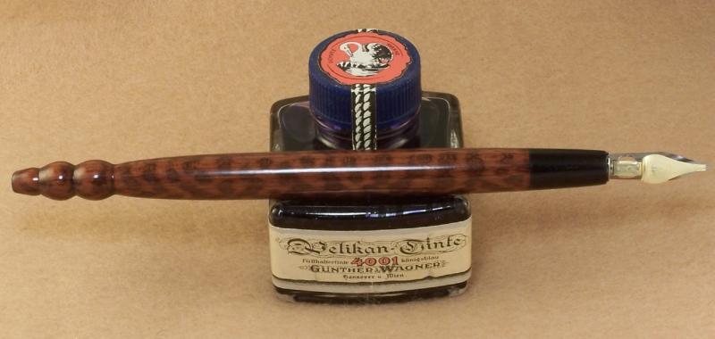

I bought a caligraphy kit from Michaels or AC Moore with a selection of Speedball nibs. I had some inserts to hold the nibs, and turned this to use with the nibs.

Thanks Cav! l was going to make just the wood handles and drill a hole l also got some new art brushes but the glue they used to hold brush part is much stronger than you think l bent the metal holder part.thanks again Cav!:)
