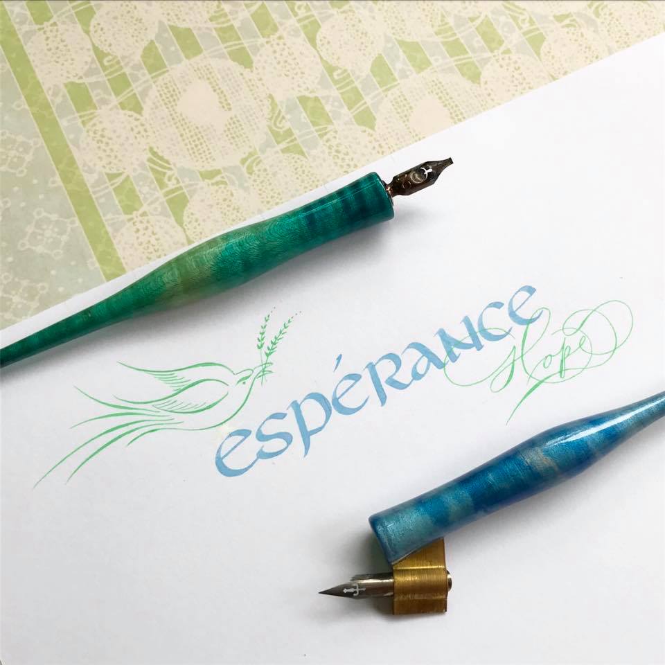

Here is some work done by Susan Lui which has been kind enough to share some information with me on facebook
attachment.php
I believe these pens were made by a Chris Held
