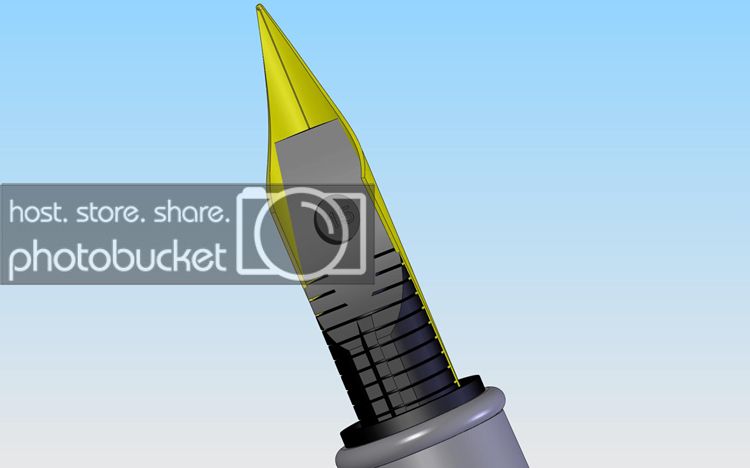

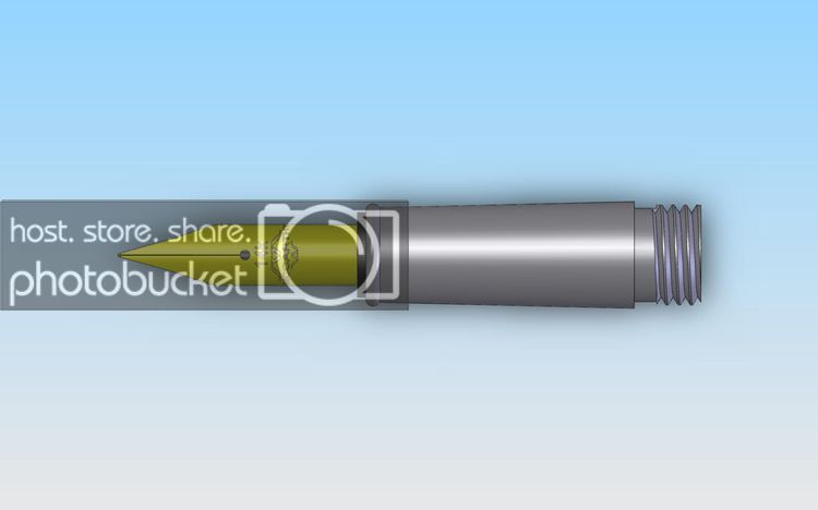

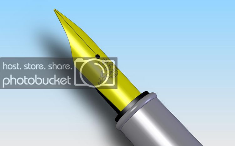

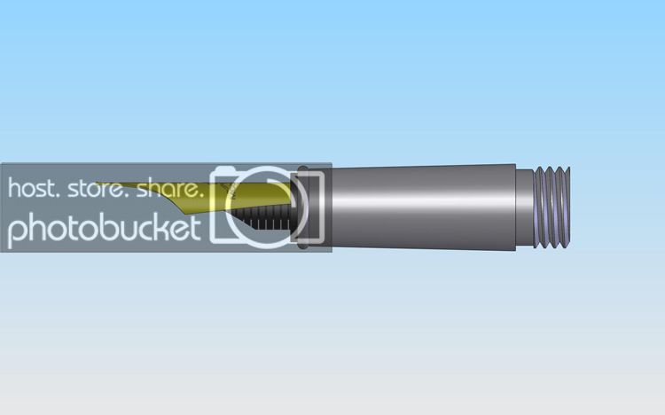

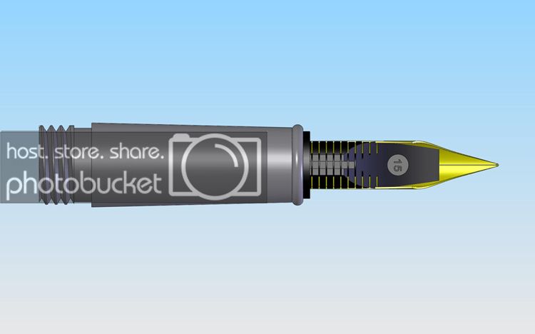

Hope everyone is having a great weekend so far! So a few days ago Chris Burton asked a question in regards to creating threads in Autocad, a CAD development program widely used in the engineering field. This made me start to think about how much fun it would be to create a CAD Solid Model of a popular fountain pen kit. So thats what I did! I decided to use the Woodcraft Titanium Navigator Fountain Pen Kit, part number 149911. This is one of the more expensive kits that are available from Woodcraft, with a list price of $31.89 here in Alabama. So, the first thing to do to create the model was to take the Nib Unit Assembly apart, in order to examine each part, and model them in my CAD program, Solidworks. This is a amazing program, and It's just wonderful to use. I used this program quite a bit during my time at Confederate Motor Company found here in Birmingham. So here we go. I will continue to model the rest of the parts for you guys this weekend, but since I had the Nib Unit Assembly finished, I thought I would share a few images with you guys. For this release, there are 13 images. I will also model a Ink Piston Unit, as well as a simple replacement Ink Cartridge. I have designed a custom Nib for this model so it will look just a little different than your Navigator Kit. So lets see what we have!
I was pleasantly surprised at how complicated what at first seems to be a simple fountain pen kit! In particular the Nib Feed Comb which is what the Nib sits on, and is what transfers the ink from the ink piston unit or the ink cartridge. Very interesting! Hope you guys like the model. And stay tuned to this thread for more updates!
