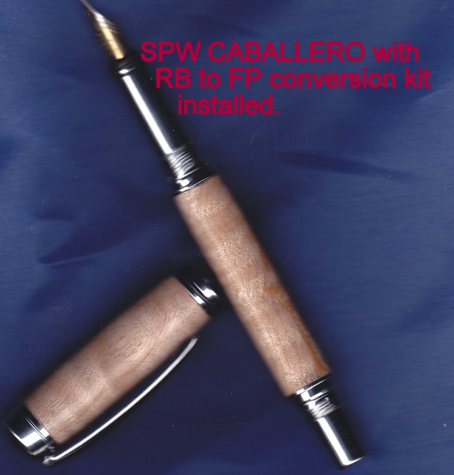

Now the Review. The only new parts visible are the trim ring and the FP front end. Both are well finished and look good.
Assembly as with all kits of this style is easy and the only thing to watch is that you get the nib coupler on the right end of the lower barrel. And that you get the trim ring on after the clip on the cap/clip/ 1/16th trim ring assembly.
As with most kits of this type you might want to add a spot of glue on the center band and on the cap/clip/trim ring assembly. I would recommend blue thread holding loctite rather than CA or Epoxy.
The finished pen looks good and the nib writes very well for a low cost nib.
