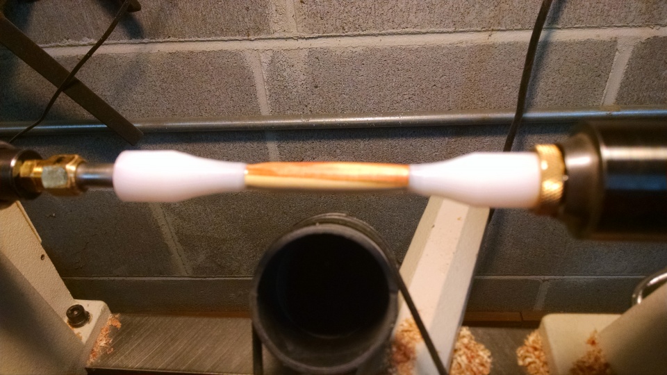

Bushings
I use nylon or some sort of white plastic instead of bushings. Quality dial calipers are a must. too.
