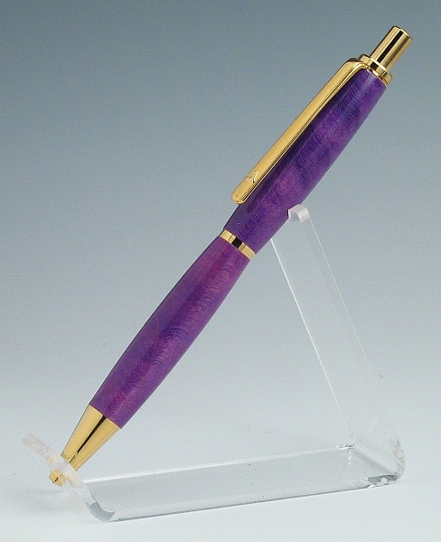

I've had no problems at all using sharpies to color the wood with a CA overcoat... Works fine.
So far it seems to work best on Maple...

Two ways of applying colors:
1. One pure overcoat so that the wood grain itself is not showing through. This is where CA will melt the colors.
As Ken said, seal them with a spray seal coat. That is a necessity.
2. Dying the wood to colors as Marc did. If your intent is to dye the wood but let the woodgrain show through, then use the markers to color the wood but wipe off excess color/build up. Let it dry totally then CA it. If it still smears, seal it with some kind of spray seal coat before CA.
